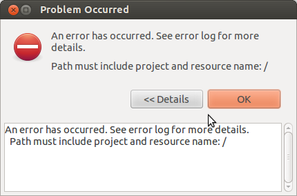

Re: Failed to update model based on selection [message #1070217 is a reply to message #1066311] Wed, 17 July 2013 09:20 Go to previous messageGo to next message
Just to make sure the error is not caused by any connector, I remove the Polarion connector - just working with local tasks. Unfortunately, I'm getting the same error again and again Sad Does anyone know how to figure out the root cause?

Re: Failed to update model based on selection [message #1076347 is a reply to message #1070217] Wed, 31 July 2013 04:11 Go to previous messageGo to next message
Meanwhile I found this bug report: https://bugs.eclipse.org/bugs/show_bug.cgi?id=406514. Unfortunately, the latest weekly build from
http://www.eclipse.org/mylyn/downloads, still shows the error message.
To get rid of the message, I temporary removed the org.eclipse.mylyn.mft.* bundles.
