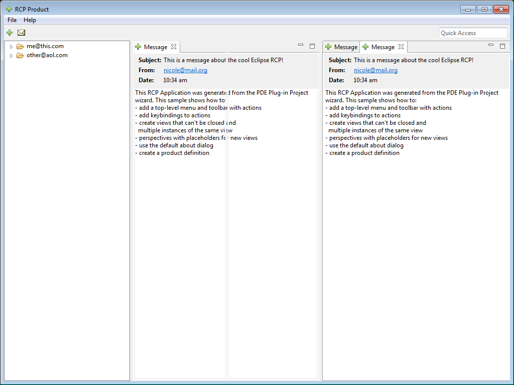

It's in fact possible to reproduce this 'problem' with the Default mail application:
- download & install Kepler
- create a fresh workspace and start the default 'Mail' RCP application
- open several messages
- move a message inside the perspective: there is only a light grey border around the view.
(see attached screenshot).
Note: swt.addons are part of the RCP Mail product.
