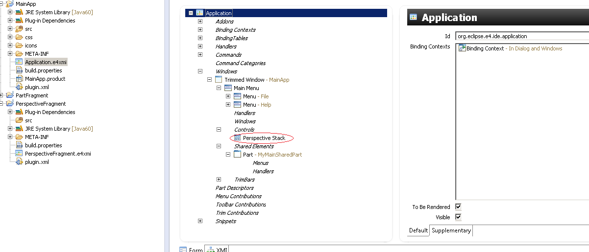

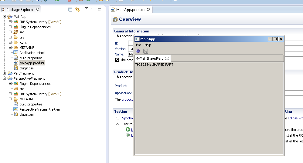

Hello all. I have three projects in my workspace:
- MainApp (contains Application.e4xmi with a TrimmedWindow [id="MainAppWindow"] and PerspectiveStack [id="MainPerspectiveStack"])
- PartFragment (contributes a Part [id="MySharedPartFromFragment"] to the Shared Elements of MainAppWindow)
- PerspectiveFragment (imports MySharedPartFromFragment and contributes a Perspective [id="SnippetPerspectiveFromFragment"] to the Snippets section of the MainApp with a PlaceHolder that references MySharedPartFromFragment)
In MainApp I have a processor that copies all Perspective Snippets into the MainPerspectiveStack (via modelService.cloneSnippet).
After MainApp starts SnippetPerspectiveFromFragment does exist in the model as a child of MainPerspectiveStack. The problem I'm having is that when I switch to the SnippetPerspectiveFromFragment perspective I see a blank MPart where MySharedPartFromFragment should be.
index.php/fa/15396/0/

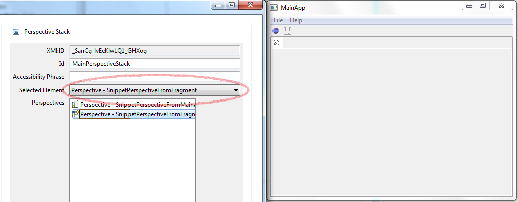

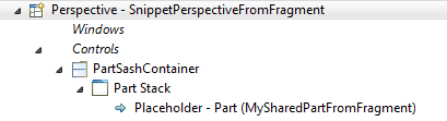

And what it looks like in the live editor:
index.php/fa/15397/0/
Any help is appreciated. I have attached the three projects.

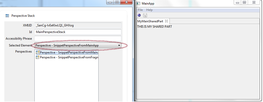

Re: Fragment/Perspective/Placeholder problem [message #1066567 is a reply to message #1065848] Wed, 03 July 2013 04:11 Go to previous messageGo to next message
Probably the issue is connected to the "empty" perspective in the "MainApp/Application.e4xmi/Application/Windows/Trimmed Window/Controls/Perspective Stack" perspective stack. After removing it from model it works for me. I attach the fixed version of the MainApp project
Daniel
Re: Fragment/Perspective/Placeholder problem [message #1067377 is a reply to message #1066567] Mon, 08 July 2013 09:14 Go to previous messageGo to next message

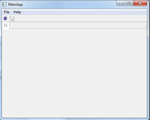

Thanks for taking the time to look at this, Daniel.
I downloaded your modified MainApp, but I still see the blank MPart after setting the SelectedElement of MainPerspectiveStack to SnippetPerspectiveFromFragment:
index.php/fa/15505/0/
I also see an exception in the console when switching to SnippetPerspectiveFromFragment:
!ENTRY org.eclipse.equinox.event 4 0 2013-07-08 08:25:11.520
!MESSAGE Exception while dispatching event org.osgi.service.event.Event [topic=org/eclipse/e4/ui/model/ui/ElementContainer/selectedElement/SET] to handler org.eclipse.e4.ui.services.internal.events.UIEventHandler@4c56666d

This exception seems to be caused by PartServiceImpl.switchPerspective(...) because it is calling ModelServiceImpl.bringToTop(MPart[elementID="MySharedPartFromFragment"]). Since MySharedPartFromFragment's eContainer is a ModelFragmentsImpl we get a null MWindow from the getTopLevelWindowFor(MPart[elementID="MySharedPartFromFragment"]) call from bringToTop(...). I'm guessing this is a bug, but maybe it is by design???
  • Attachment: MainApp1.png
    (Size: 18.05KB, Downloaded 2200 times)

Do you use the latest Kepler release or other version? I'am asking since I have double checked it with Kepler and it works for me. So after removing the empty perspective from the model (see the 'snapshot2.png' attachment) and running the application I get the valid part (see the 'snapshot.png' attachment)
Daniel
  • Attachment: snapshot.png
    (Size: 35.80KB, Downloaded 296 times)
  • Attachment: snapshot2.png
    (Size: 38.94KB, Downloaded 323 times)

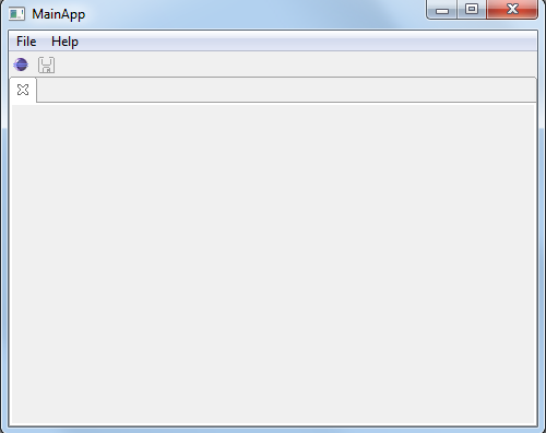

Thanks for the response, Daniel. I am using Kepler Release build id 20130614-0229. I also see the problem in Juno SR2.
Your attached screenshot (snapshot.png) is exactly what I see when I first run the application. I've been seeing that exact screenshot all along- even with a non-empty Perspective stack (as attached in my first post). The issue happens when I run the application, open the live editor, and switch the Selected Element of MainPerspectiveStack to the SnippetPerspectiveFromFragment Perspective.
This screenshot is the initial state (same as yours):
index.php/fa/15557/0/
This screenshot is the bad state after I switch perspectives to SnippetPerspectiveFromFragment:
