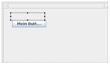

im using juno (4.2) on Ubuntu 12.04 (32bit). Sometimes, if i select an element on the design tab, the selection frame is above the element. I attached a image, which shows this issue.
If i refresh the view, mostly this error disappears

i tested it with Unity 2D, which use metacity as window manager, and the problem disappears. Under normal Unity which use compiz if have this problem. To reproduce this error, just use Absolute Layout and on Button.

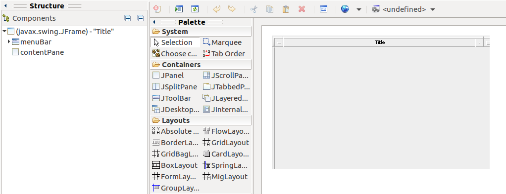

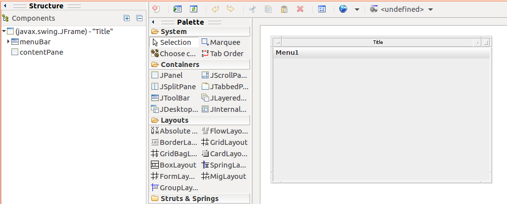

I created sample JFrame with default settings and added menu bar.
Just pressing <F5> to update the window brings different results as if WindowBuilder has internal RNG to decide the outcome.
Compiz or no Compiz, I believe it's WB to blame in this case.
I attached three screenshots to illustrate my point.
