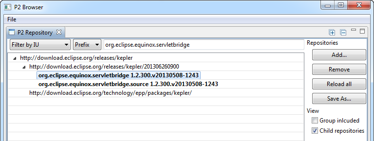

Re: equinox servlet bridge and Kepler [message #1095230 is a reply to message #1064042] Mon, 26 August 2013 16:12 Go to previous message
Are you refering to Equinox in a Servlet Container? (outdated bridge.war example on this page)
I did find servletbridge 1.2.300.v20130508-1243 jar on the Kepler Update site:
http://download.eclipse.org/releases/kepler
index.php/fa/15785/0/
View of this repository (using the P2 Browser application).
