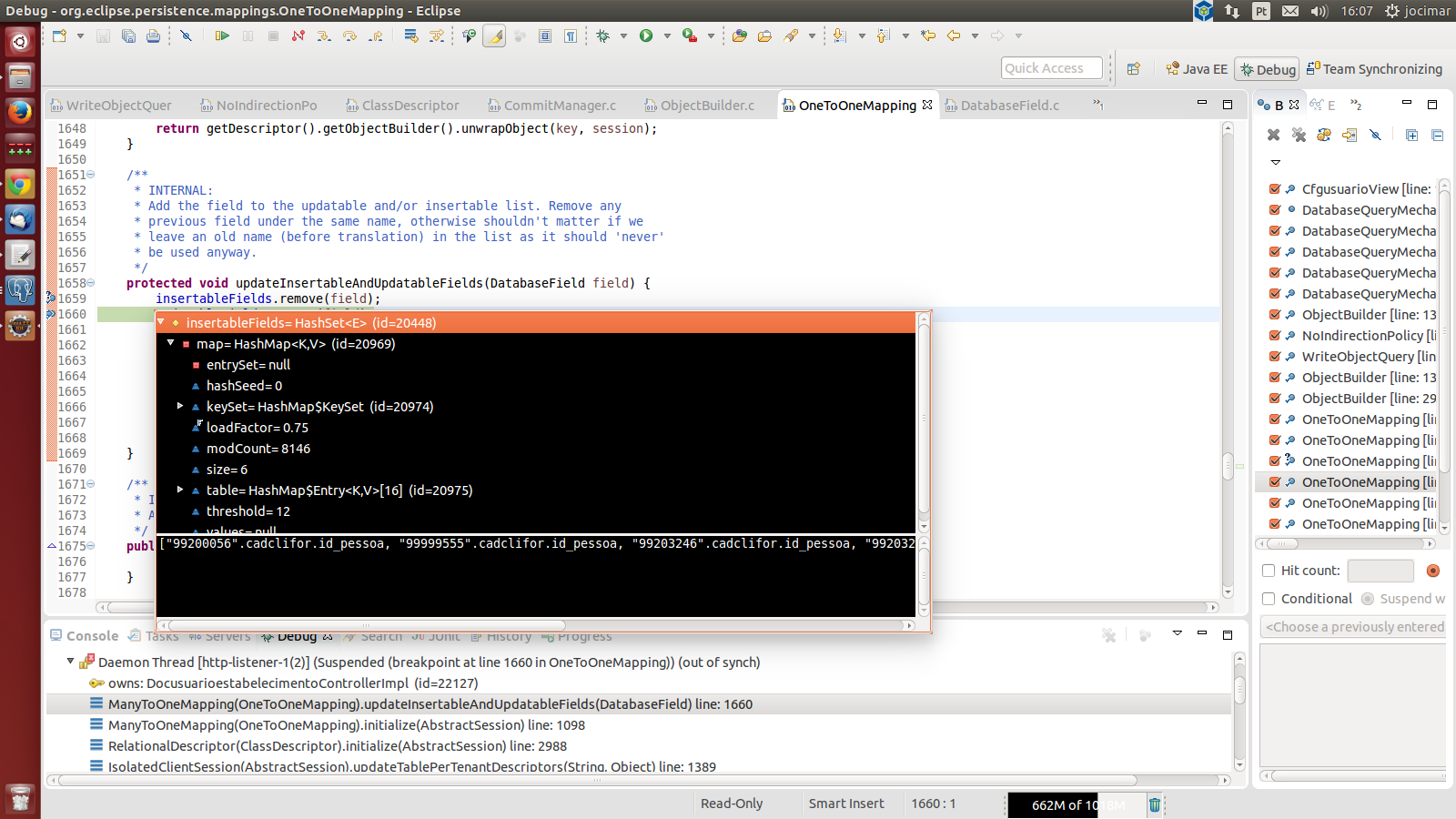

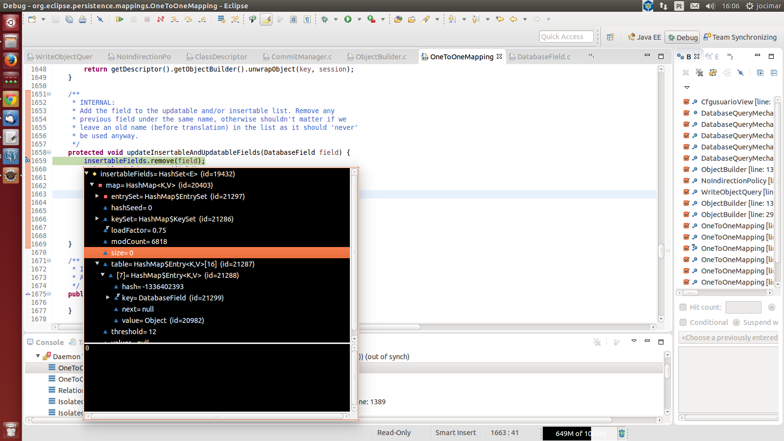

More information, many objects are cloned including mappings related fields as images attached. In OneToOneMapping the Map insertableField
many objects are added in map mantening one instance per tenant.
But after some time using the system the HashSet insertableField in OneToOneMapping presents its size zero and the internal table
contains a value look image two, and when the system will run insertableFields.contains method the field is not localized and thus is not added
the query causing the following error :
Internal Exception: org.postgresql.util.PSQLException: ERROR: null value
in column "id_usuario" violates not-null constraint
Detalhe: Failing row contains (null, 0, 1).
INSERT INTO "99200056".cfgusuario (st_avisosonorochat,
st_disponibilidadechat) VALUES (?, ?)
bind => [1, 0]
