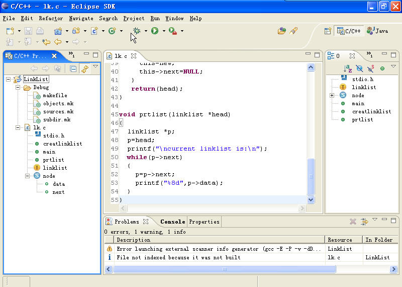

Hello!
why my CDT can not build my project althongh i do it by the guide?
here is a picture of it
it is:
  • Attachment: Snap1.jpg
    (Size: 91.34KB, Downloaded 122 times)

Read the messages! It says Error launching external info generator (gcc
-E -f -v -dD...)
Do you have gcc (the directory "bin") within your PATH? I gues not!
