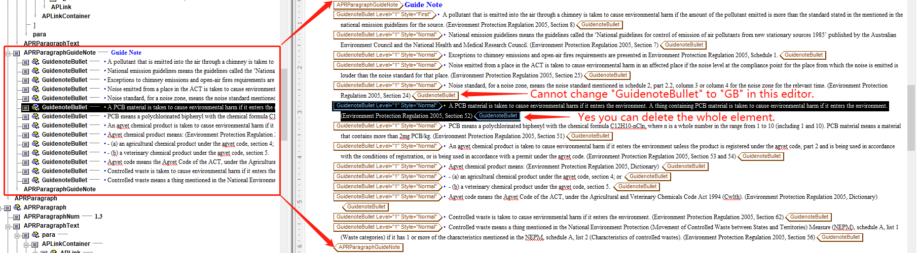

Recently I'm looking for an alternative solution for Arbortext XML editor and I'm wondering if Eclipse could be the one.
One thing important to us is that Arbortext XML editor can protect the name of elements defined in DTD file from being changed while editing the content of the XML file -- means you can delete the whole element (with its children) but cannot change the name defined in DTD file, as attached screen snapshot showed.
Can I just change some settings to let Eclipse XML editor works in the same mode? Or Do I have to create a plugin myself to customize it? Thanks.
