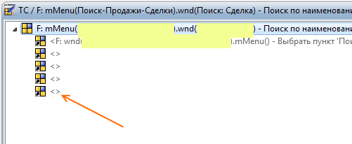

We've found a bug that removes test case browser folders(categories).
As a result cases which were in the removed folder can't be found by search mechanism. They still remain in cases they are used but can't be modified.
So after creating new project version we have "missing test data" instead of them.
