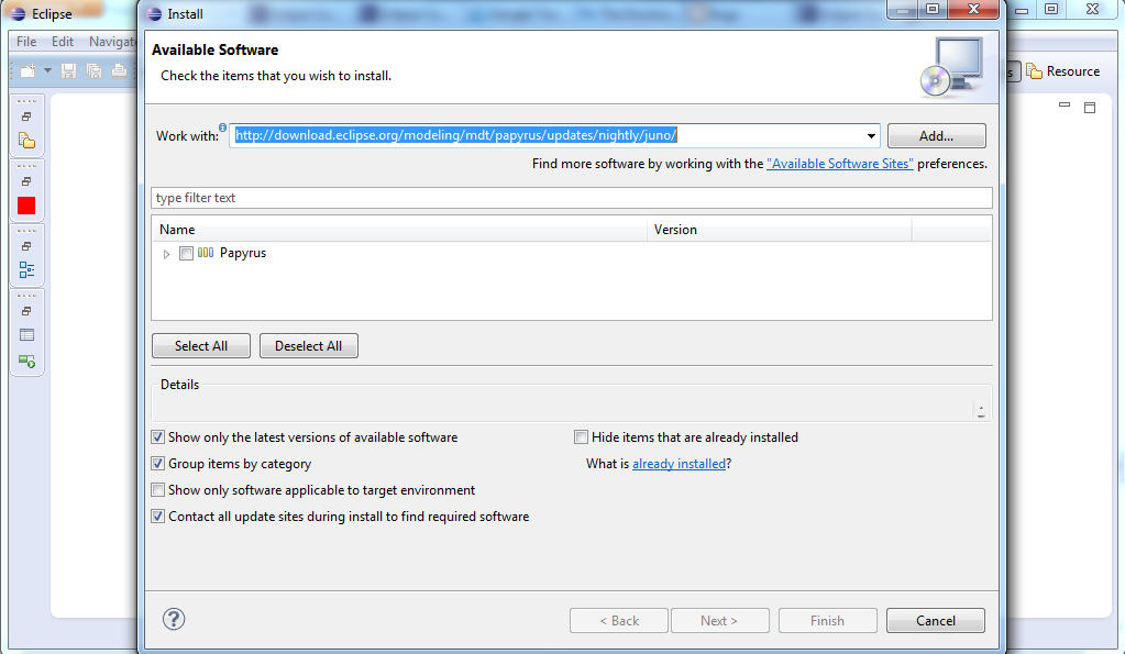

Now ,I would like to update my version using Update sites for Papyrus nightly builds
so I followed the following steps:
Menu Help/Install New software/ and enter the update site
http://download.eclipse.org/modeling/mdt/papyrus/updates/nightly/juno/
http://postimg.org/image/d24pesnfr/
and then
http://postimg.org/image/3ma362qwh/
and the last step was
http://postimg.org/image/kmg6bi8eb/
1-How the last step can be processed?
2-How regularly the Papyrus version should be updated? Is it advisable to update my version every night as its name implies(nightly builds)?

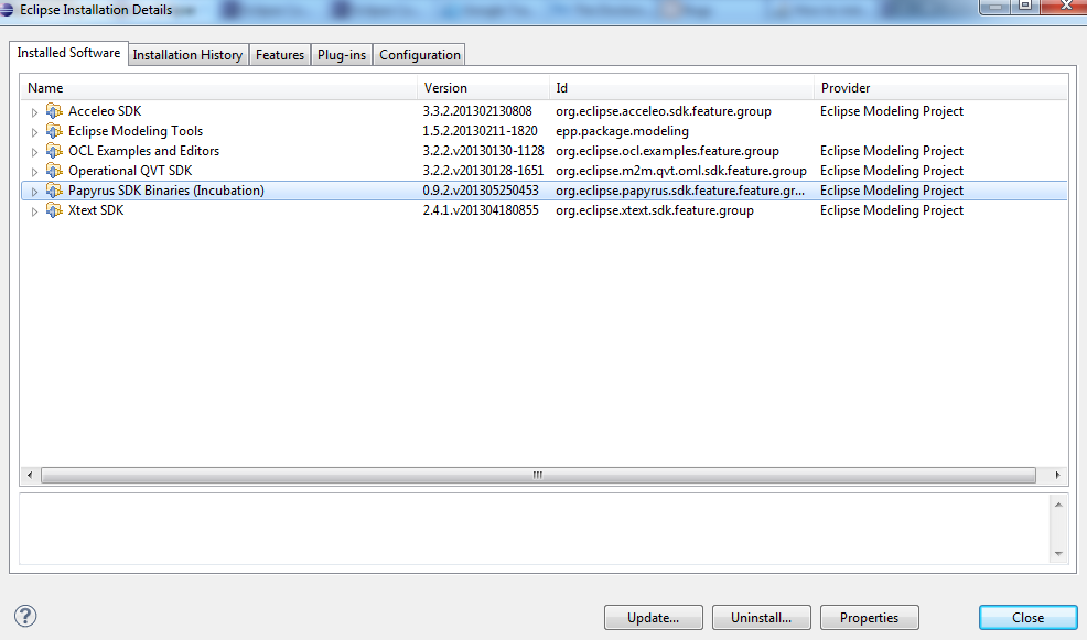

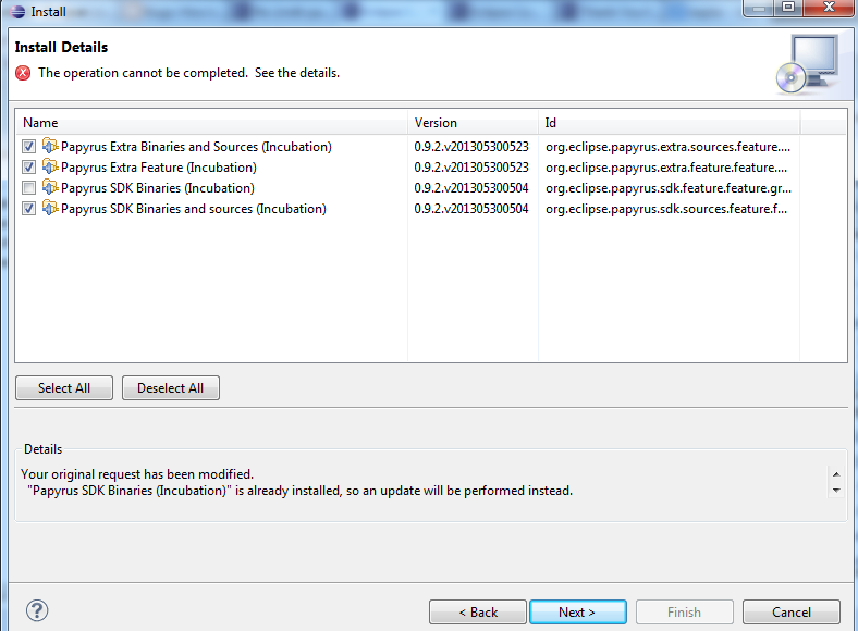

Camille, thank you very much that's very kind of you.
I followed your instructions:
1-Uninstall all extra components (Except Papyrus UML) as illustrated through screenshot in the attachment
2-Go back to Help / Install new software and enter the update site
(also illustrated through screenshot in the attachment 3,4)
-I can't proceed this step .Does I miss some steps?
-Does the method that you provided (help-->check for update) is about Papyrus release versions or Papyrus nightly builds?
because I noticed this method doesn't ask me to enter any update link through updating process.
Andrew
Re: Update sites for Papyrus nightly builds [message #1061239 is a reply to message #1061236] Thu, 30 May 2013 12:57 Go to previous messageGo to next message
The "Check for updates" action will use all available update sites. So, it depends on what you've configured in the "Install new software" dialog.
For the other error, I guess this is the same kind of issue, although I couldn't tell what exactly is wrong. So I'll recommend the same thing: Uninstall Papyrus SDK, and try to install it directly from the nightly update site.
Camille

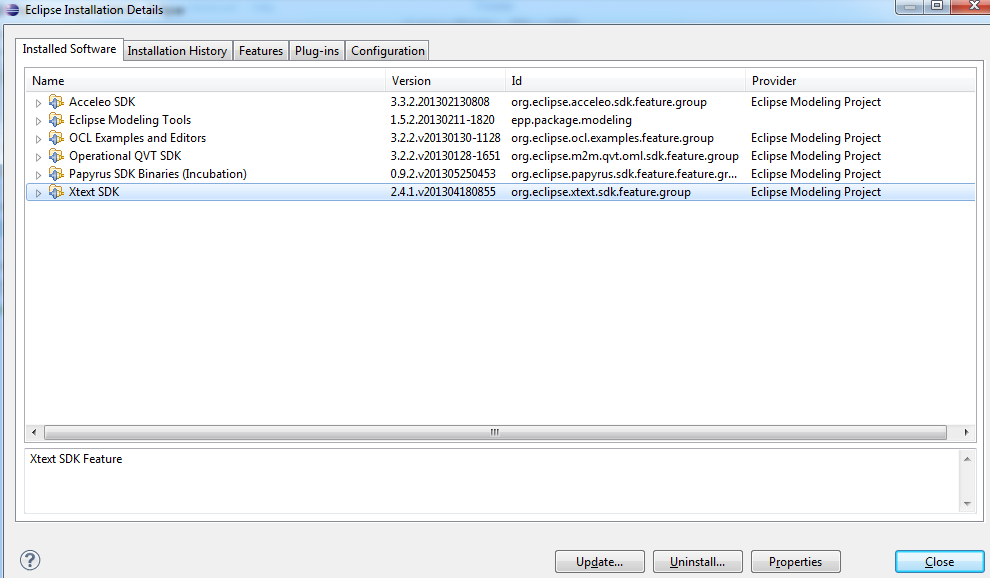

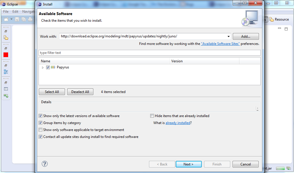

Re: Update sites for Papyrus nightly builds [message #1061252 is a reply to message #1061239] Thu, 30 May 2013 14:56 Go to previous messageGo to next message
Hi Camille !
The following is another try :
1-Uninstall Papyrus SDK.
(I illustrated it through screenshot in the attachment)
2-Install Papyrus SDK directly from the nightly update site
(also illustrated through screenshot in the attachment )

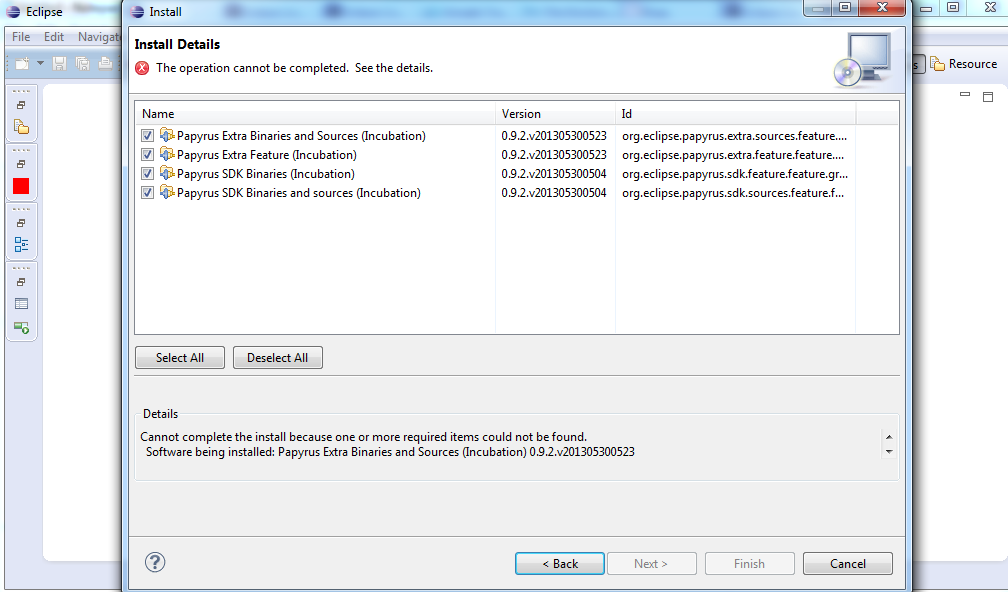

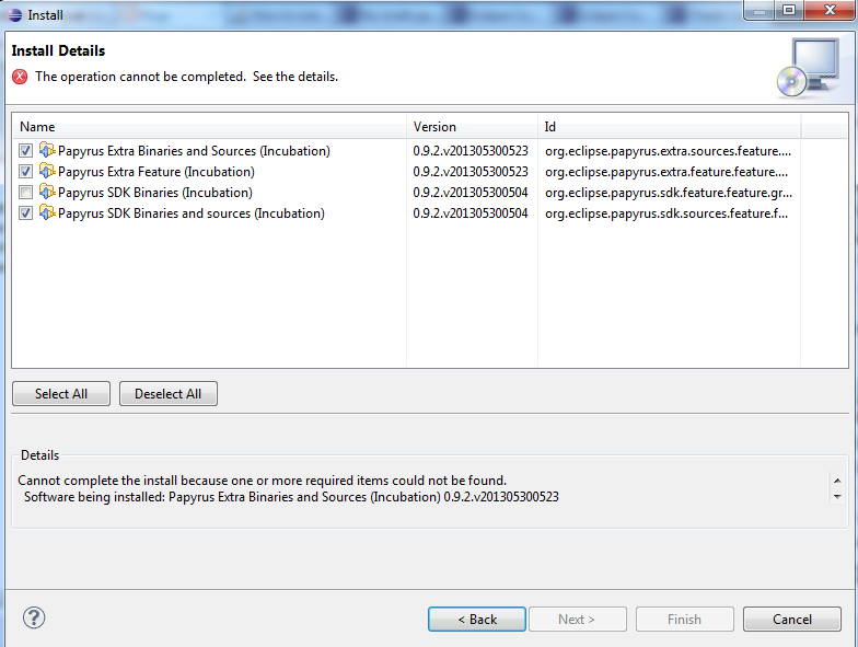

but I can't proceed this step because of the following error:
cannot complete the install because one or more required items could not be found
Could you please check the attachments?
Andrew
  • Attachment: 1.PNG
    (Size: 75.14KB, Downloaded 678 times)
  • Attachment: EMF-2-.PNG
    (Size: 64.00KB, Downloaded 275 times)
  • Attachment: 3.PNG
    (Size: 113.15KB, Downloaded 270 times)
  • Attachment: 4.PNG
    (Size: 114.76KB, Downloaded 259 times)
  • Attachment: 5.PNG
    (Size: 105.69KB, Downloaded 256 times)
Re: Update sites for Papyrus nightly builds [message #1061331 is a reply to message #1061252] Fri, 31 May 2013 05:10 Go to previous messageGo to next message
If the error message (Which is partially hidden in Screenshot 5) is the following:
Cannot complete the install because one or more required items could not be found.
  Software being installed: Papyrus Extra Binaries and Sources (Incubation) 0.9.2.v201305310519 (org.eclipse.papyrus.extra.sources.feature.feature.group 0.9.2.v201305310519)
  Missing requirement: UML Compare Models (Incubation) 0.9.2.v201305310519 (org.eclipse.papyrus.uml.compare.subelement 0.9.2.v201305310519) requires 'bundle org.eclipse.emf.compare.uml2 0.0.0' but it could not be found
Then you need to add the following update site:
EMF Compare 1.3 Releases - http://download.eclipse.org/modeling/emf/compare/updates/releases/1.3
If the error message is different, please provide the full error message.
Camille

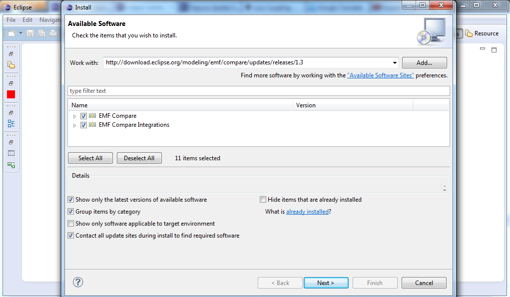

Re: Update sites for Papyrus nightly builds [message #1061414 is a reply to message #1061405] Fri, 31 May 2013 10:13 Go to previous messageGo to next message
You should add this update site, then try again:
Camille

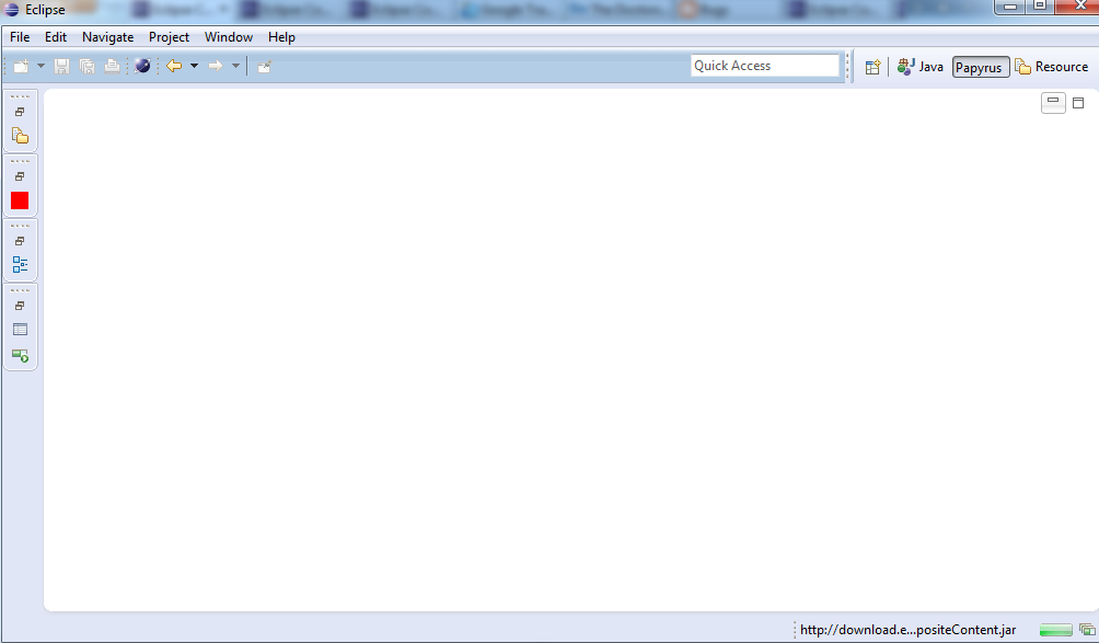

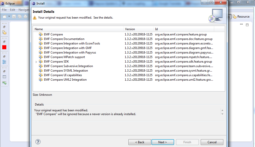

Re: Update sites for Papyrus nightly builds [message #1061432 is a reply to message #1061414] Fri, 31 May 2013 11:22 Go to previous messageGo to next message

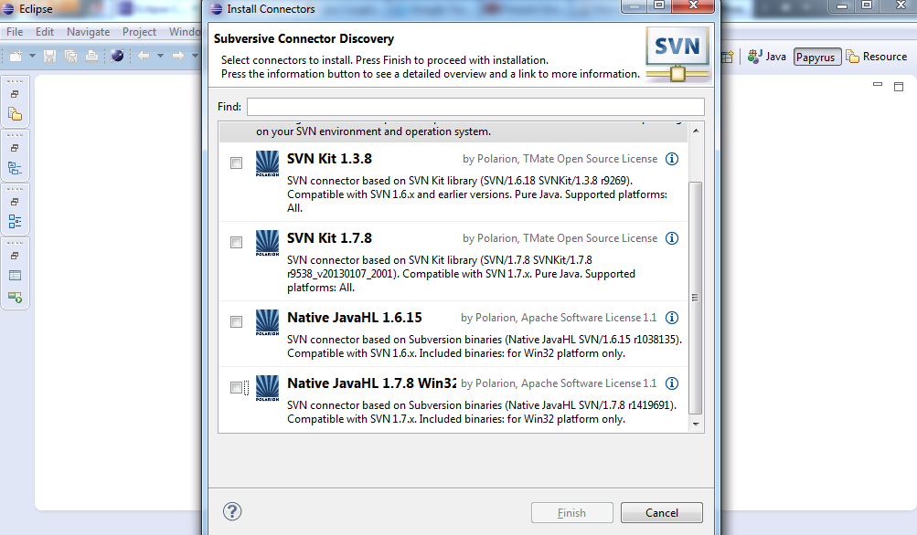

Hi Camille !
After adding the following update site and then starting up Eclipse Modelling Framework I got a dialog
Is it a bug or I should install one of these connector?
Andrew
  • Attachment: 1.PNG
    (Size: 117.43KB, Downloaded 306 times)
  • Attachment: 2.PNG
    (Size: 125.10KB, Downloaded 254 times)
  • Attachment: svn.PNG
    (Size: 123.38KB, Downloaded 288 times)
[Updated on: Fri, 31 May 2013 11:27] by Moderator
Re: Update sites for Papyrus nightly builds [message #1061438 is a reply to message #1061432] Fri, 31 May 2013 11:46 Go to previous messageGo to next message
Actually, adding the update site would've been enough (Just so that Papyrus Compare can resolve its required dependency to EMF Compare). You installed all the EMF Compare integration components, including the Subversive (SVN) integration. Subversive opens this dialog when it cannot find any SVN connector.
So, you can simply ignore this dialog.
Camille

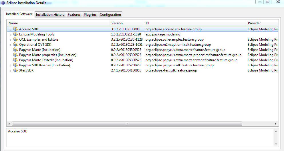

Re: Update sites for Papyrus nightly builds [message #1061452 is a reply to message #1061438] Fri, 31 May 2013 12:52 Go to previous messageGo to next message
Hi Camille !
After successfully completing the installation of Papyruss (Menu Help/Install New software/ and enter the update site
) and trying to add MARTE
(Help--> install Papyrus additional components-->flag MARTE) some errors occured
Andrew
