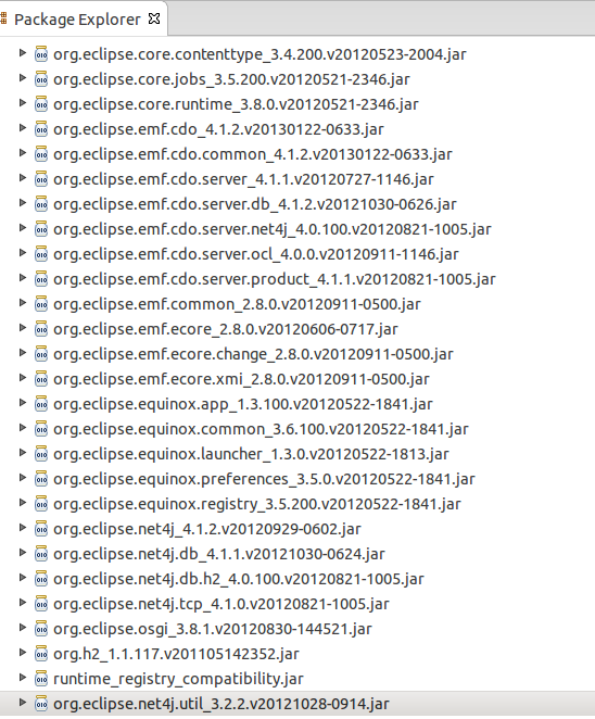

i attached a picture with my included plugins (for the server). i already included 'org.eclipse.emf.cdo.server.ocl_4.0.0.v20120911-1146.jar' (as mentioned in other threads) and in the osgi-terminal it is marked as resovled.
i also tested the precompiled server from 'emf-cdo-R20130213-0014-CDOServer-Linux.zip' (also added the ...server.ocl-jar) and i got the same error.

Re: Once again Factory not found: org.eclipse.emf.cdo.server.queryHandlerFactories[ocl] [message #1060670 is a reply to message #1060537] Mon, 27 May 2013 11:56 Go to previous messageGo to next message
Am 27.05.2013 14:34, schrieb bobby car:
> i know there are already a few threads about this error, but none of them solved my problem.
> i built a standalone server
A standalone server needs to register the needed factory via:
OCLQueryHandler.prepareContainer(IPluginContainer.INSTANCE);
Cheers
/Eike

Re: Once again Factory not found: org.eclipse.emf.cdo.server.queryHandlerFactories[ocl] [message #1060682 is a reply to message #1060670] Mon, 27 May 2013 13:36 Go to previous messageGo to next message
that and a few more dependencies seem to fix my problem
Thanks Eike
