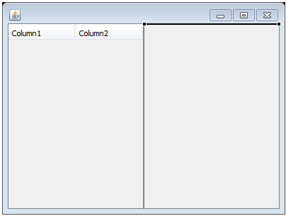

It seems like WindowBuilder does not display table headers if they were created by calling JTable.addColumn().
The left shows a table created using setModel() and the right a table created using addColumn()

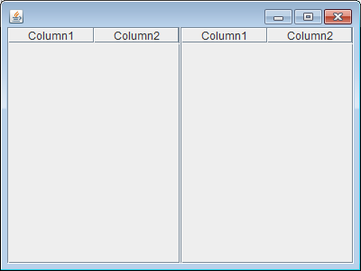

At runtime, they both look the same.

WindowBuilder does not currently support the addColumn() method, so it does not try to parse it.
Since addColumn() is not a simple JavaBean property, special design-time support would need to be added for it.
I would suggest adding a feature request to Bugzilla describing the need so that we can track it for future work. WB is open source, so we would certainly welcome a patch that added that capability.
