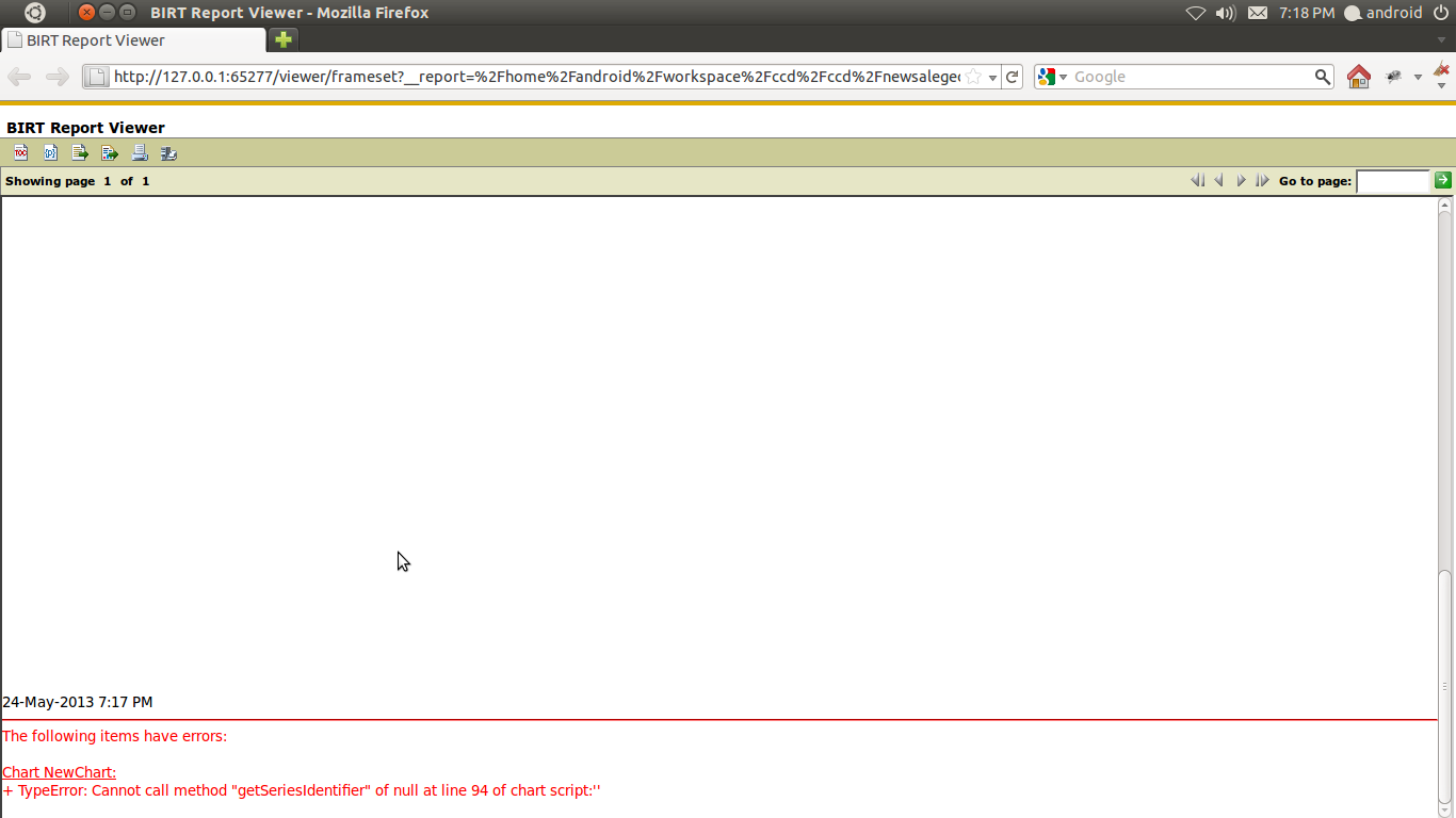

again it struggle a lot...(i.e)if i don't have data in databases it generate a error script are produced
give some idea how to remove error..and then if i dont have value in databases at that time i have to produce some alert msg like......
"there is no data like that...."

To avoid something like this, you'd just need to check if the series was null before trying to check the series identifier. If it was, you'd stop doing any script and then could show a text in your report letting you know that the data was null. Hope this helps.
