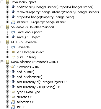

here is a picture of my model:
index.php/fa/14997/0/
i defined DataCollection as generic F, which extends GUID.
and all of these informations are defined
any ideas whats going wrong?

On 22/05/2013 7:56 AM, Ludwig Moser wrote:
> Warn: The generic type associated with the 'DataCollection' classifier should have 1 type argument to match the number of type parameters of the classifier.
I don't see a use of DataCollection in your screen shot. To specify the
type arguments at the point of use, ensure that Sample Ecore Editor ->
Show Generics is enabled, and use "New Child -> EGeneric Type Argument"
to create the arguments; they'll start out as a wildcard but via the
properties you can reference an EClassifier or an ETypeArgument.
> Error: The typed element must have a type
I don't see what causes this error in the screen capture. Which typed
element doesn't have a type?
> thanks in advance

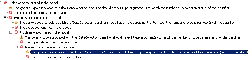

Re: How to resolve this error? [message #1059913 is a reply to message #1059899] Wed, 22 May 2013 03:29 Go to previous messageGo to next message
both ecore files report no errors nor warnings when i call validate!
the genmodel shows me errors & warnings.
index.php/fa/15002/0/

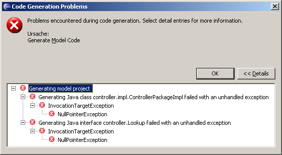

i tried to generate the code which results in an exception
index.php/fa/15003/0/
Re: How to resolve this error? [message #1059925 is a reply to message #1059913] Wed, 22 May 2013 04:11 Go to previous messageGo to next message
Are you using the right Validate? If you have WTP installed, it
contributes another absolutely useless menu entry; almost seems designed
to cause trouble.
Ed Willink
> the genmodel shows me errors& warnings.
Re: How to resolve this error? [message #1059928 is a reply to message #1059924] Wed, 22 May 2013 04:27 Go to previous messageGo to next message
arr, you are right, there are two validate (did not notice that until you point me on it now :-/)
as i now use the right one, i get pointed to the error.
and was able to resolve it within minutes (i lost some days due this damn second validate entry)
thanks for your help ed.
