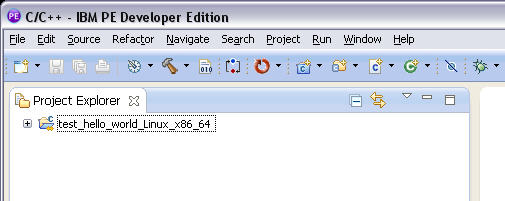

Note: If I run that same test to my AUT on Windows XP SP 3 it runs successfully. Let's call this machine autwindows. In other words, the test case drives the AUT and the I see the mouse move, the File & Exit menus get selected, etc. all of which I am viewing on my local Windows display (not through VNC).

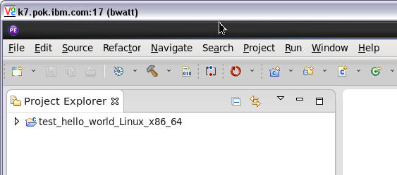

There is no auto-mapping taking place. The VNC display is fixed and represents the Linux GNOME desktop which consists of a title-bar and as set of desktop menus. When the Jubula RC clicks on a menu item it skips the title bar, but then tries to selects one of the GNOME desktop menu items accidentally. In other words, the Jubula RC is unaware of where the top left corner of the AUT is started (relative location) and instead treats the top left corner of the VNC display (absolute location).
See index.php/fa/14992/0/.

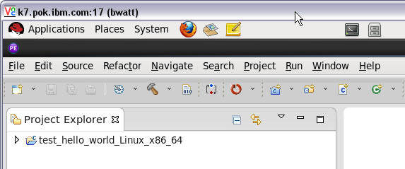

So I was able to configure GNOME to move its set of desktop menus to the bottom of the screen. Again it failed because it tried to select the AUT's title-bar's window menu items. It looks like it was again selecting from the top left corner of the VNC display (absolute location).
See index.php/fa/14993/0/.
As I said earlier everything works fine on Windows (non-VNC) because there is no graphical 'overhead', that is, the title bar and menu belong to the AUT.
See index.php/fa/14994/0/.

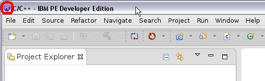

One more piece of information. I ran on the remote Linux machine, autlinux, without using VNC, but instead using X-Windows and exported my display output back to an X-server running on my Windows, autwindows. What surprised me is that this still failed. I see the cursor moving to the top left corner and selecting the Windows menu that is in the title bar (circled in red below) and not the AUT "File" menu item just below it. Then I get an error back in Jubula stating "The submenu for "File" did not appear."
index.php/fa/15015/0/
