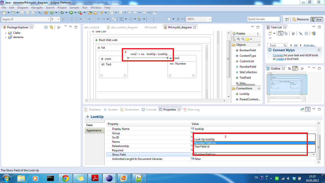

I have this metamodel;
(i only showing releations)
abstract Field
LookUp extends Field
  contentType -> 1..1 ContentType (referance)
  showField  -> 1..1 Field (reference)
Content Type
     ownedField -> 0..* Field(containment)
here i just want when user select showfield feature from properties section of LookUp Field, GMF must show only its referenced ContentType element Field's. But when i generate GMF it shows all created Field. How can i constraint this ? anyone can help me ?
(Example attached as a picture)
on example LookUp defined and cnn2 ContentType set as its ContentType referance feature. But when i click showField from properties section i must have only 'no' Number Field. But it gives me all fields. But i need only no Number field. How can i do this anyone can help me ?
  • Attachment: LookUp.png
    (Size: 162.24KB, Downloaded 527 times)

Re: Property Selection Filter on Property Section [message #1060347 is a reply to message #1059575] Fri, 24 May 2013 04:46 Go to previous messageGo to next message
this is done via the .edit code that is generated by emf. Take a look at this http://wiki.eclipse.org/EMF-FAQ#How_can_I_control_which_instances_are_available_as_choices_when_editing_a_property_in_the_properties_view.3F .
Ralph
Re: Property Selection Filter on Property Section [message #1060406 is a reply to message #1060347] Fri, 24 May 2013 09:54 Go to previous messageGo to next message
thanks a lot i fixed my problem via above url.
