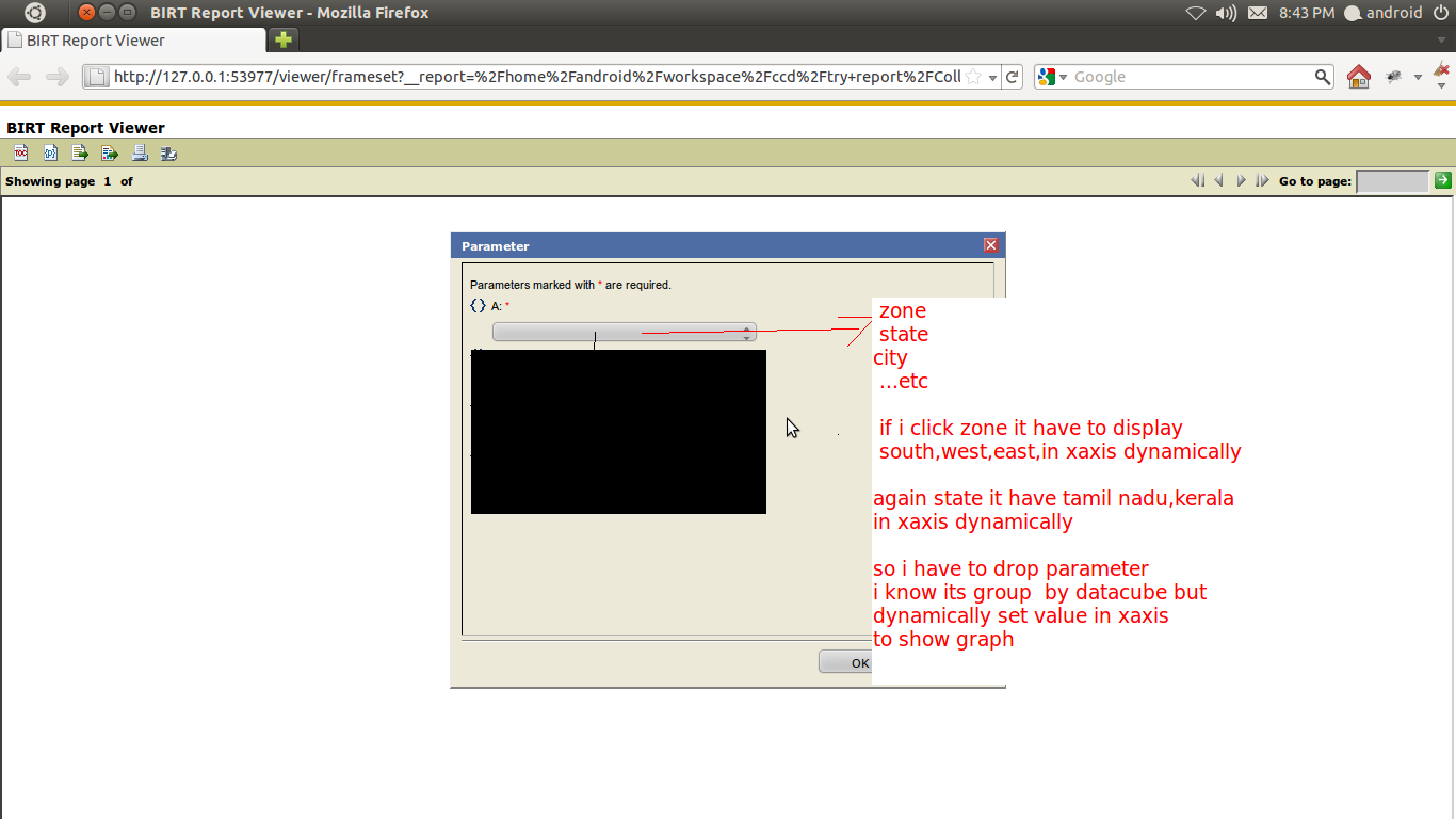

in this script we are getting baseAxes value according to parameter
function beforeGeneration(chart, icsc)
importPackage( Packages.org.eclipse.birt.chart.model.attribute.impl );
importPackage( Packages.org.eclipse.birt.chart.model.attribute );
xAxis = chart.getBaseAxes()[0];
if ( xAxis.getType() == AxisType.DATE_TIME_LITERAL){
var groupparm = icsc.getExternalContext().getScriptable().getParameterValue("pDateGrouping");
if( groupparm == "Days")
xAxis.setFormatSpecifier( JavaDateFormatSpecifierImpl.create("MM/dd/yyyy") );
else if( groupparm == "Years" )
xAxis.setFormatSpecifier( JavaDateFormatSpecifierImpl.create("yyyy") );
else if( groupparm == "Months" )
xAxis.setFormatSpecifier( JavaDateFormatSpecifierImpl.create("MM/yy") );
else if( groupparm == "Quarters" ){
xAxis.setFormatSpecifier( JavaDateFormatSpecifierImpl.create("'Q'Q/yy") );
my requirement
if ( xAxis.getType() == AxisType.TEXT_LITERAL){
var groupparm = icsc.getExternalContext().getScriptable().getParameterValue("geography");
if( groupparm == "zone")
xAxis.?( ?.create("?") );
else if( groupparm == "state" )
else if( groupparm == "city" )
like wise i have one table in that many columns are there zone,state,city,...its go on
so now my doubt is
for example:
if i click option "zone" in list box i have get value in bar chart south,west,east,north in x-axis and corresponding net sale in y axis....
if i click option "state" in list box i have get value in bar chart tamilnadu,kerala,chennai, in x-axis and corresponding net sale in y axis....
thanks in advance..............

Re: how-to-get-a-x-axis-label-value-by-parameter-in-bar-chart [message #1059141 is a reply to message #1058527] Thu, 16 May 2013 20:39 Go to previous messageGo to next message
Take a look at the modified design attached. In the original query, I alias the fields, as you did in your original dataSet. I then use the parameter value to modify the query in the beforeOpen to change the field brought in under the xaxis alias.
The chart is set up to use the fields xaxis and yaxis, so it doesn't care what the query is. Hope this helps.

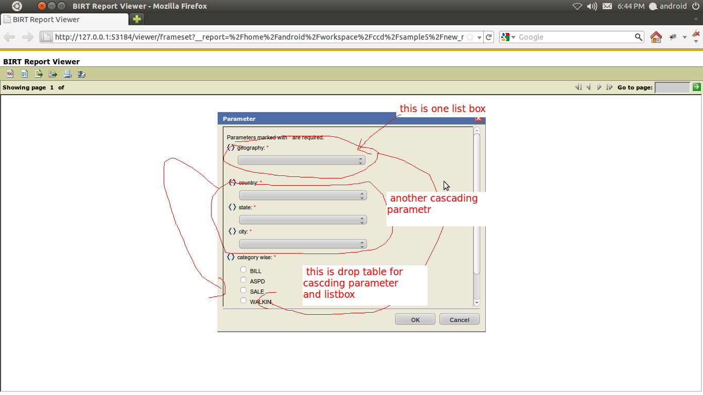

Re: how-to-get-a-x-axis-label-value-by-parameter-in-bar-chart [message #1059567 is a reply to message #1059409] Mon, 20 May 2013 10:01 Go to previous messageGo to next message
hi thanks for reply....
my requirement is:
1)geography-------->listbox
2) country------------cascading parameter
zone
state
city
...etc
3)to drop table
like 1) bill
2)sale
3)etc....
my question is when i select in geography value and i have to drop a table
and then again i will select from cascading paramter and i will drop same table
i have run both by separate it run ......good
when i combine in same report it cant be run....so it possible to exceute in same report
i have used a to drop a table in before factory
a = reportContext.getReportRunnable().designHandle.getDesignHandle().findElement("apc");
b = reportContext.getReportRunnable().designHandle.getDesignHandle().findElement("aspb");
c = reportContext.getReportRunnable().designHandle.getDesignHandle().findElement("bill");
d = reportContext.getReportRunnable().designHandle.getDesignHandle().findElement("aspd");
e=reportContext.getReportRunnable().designHandle.getDesignHandle().findElement("sale");
f=reportContext.getReportRunnable().designHandle.getDesignHandle().findElement("walkin");
if (params["Table"].value == "APC")
b.drop();
c.drop();
d.drop();
e.drop();
f.drop();
if (params["Table"].value == "ASPB")
a.drop();
c.drop();
d.drop();
e.drop();
f.drop();
if (params["Table"].value == "BILL")
a.drop();
b.drop();
d.drop();
e.drop();
f.drop();
if (params["Table"].value == "ASPD")
a.drop();
b.drop();
c.drop();
e.drop();
f.drop();
if (params["Table"].value == "SALE")
a.drop();
b.drop();
c.drop();
d.drop();
f.drop();
if (params["Table"].value == "WALKIN")
a.drop();
b.drop();
c.drop();
d.drop();
e.drop();
