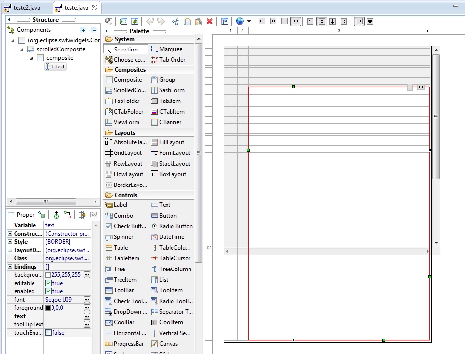

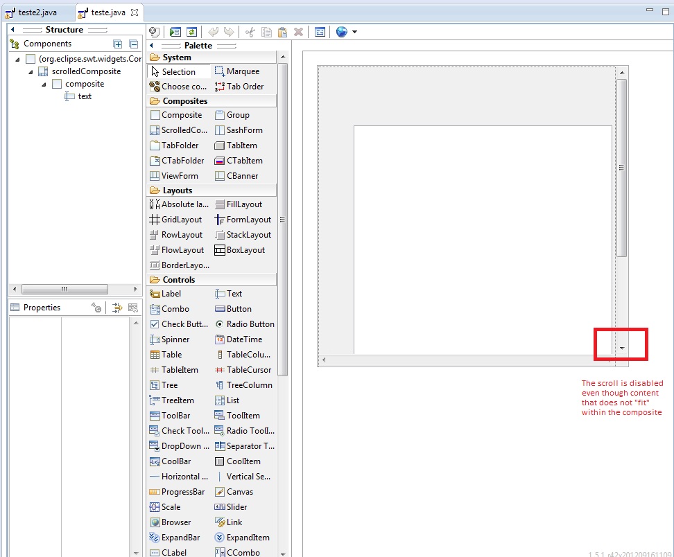

I am using a ScrolledComposite within a Composite to draw a screen.
When I run the screen, the scroll works correctly, but when I'm drawing, or when I'm using Window Builder to create my screen the scroll does not work.
And that's exactly when designing the screen that I need the scroll work.
As you can see ScrolledComposite know you have more content in the composite.
index.php/fa/14671/0/
However, the scroll bar does not work!
index.php/fa/14670/0/
Anyone know how to enable scroll in this case?
Thank you
Re: ScrolledComposite [message #1053642 is a reply to message #1053616] Tue, 07 May 2013 01:32 Go to previous messageGo to next message
When you are editing a screen, you are not dealing with actual live widgets so there is no real scroll bar to interact with.
The typical way to handle a UI like this is to create the composite as a separate class, edit it independently of the main UI, and then place an instance of that composite within the scrolled composite.
