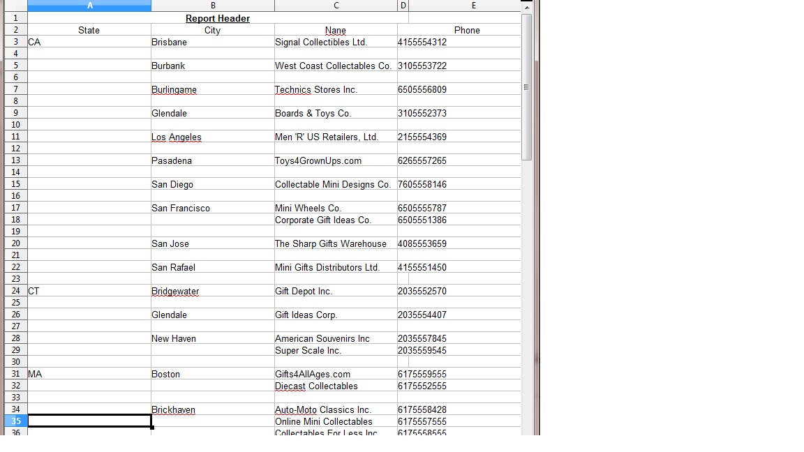

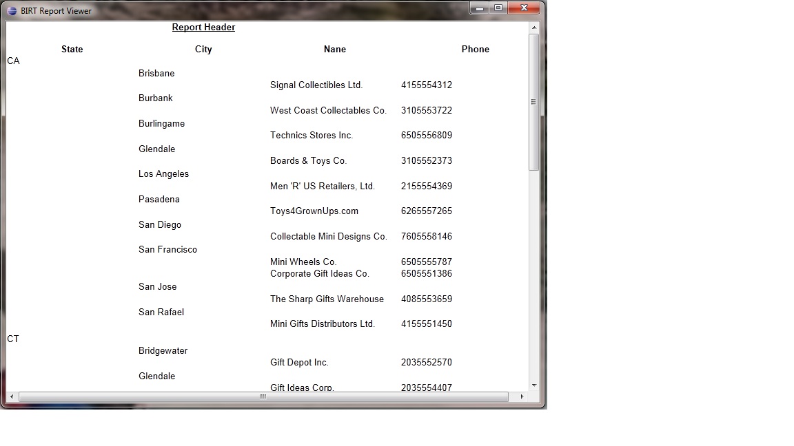

I'm new to BIRT and just started the tutorial this morning. I noticed that when the data breaks from a group, like state to state or city to city within a state, the group value gets displayed on it's own line and then the details are displayed on the next line. Is there any way for the group value/data to be displayed on the same line as the detail data?
I've attached a picture of what the report is doing and a picture of what I would like it to look like after reformatting the data in a spreadsheet.

Yes this issue is about formatting a report. The bottom line is can I suppress printing a newline character when a new group value is displayed/printed? The format I want is shown in the second image of my original post.
Re: Group data on same line as detail data - How to? [message #1053194 is a reply to message #1053093] Fri, 03 May 2013 01:04 Go to previous messageGo to next message
If you select the cell that contains the element in the group row and go to the general tab of the property editor and set the drop property to "detail", you should get what you're wanting. Let me know.

OK, I played around some more and found the drop property. I had clicked in the wrong cell. The problem now though is that the drop property is only available in cells in which I don't have a value defined. When I set the property to detail in certain cells it drops the value displayed in that column.
