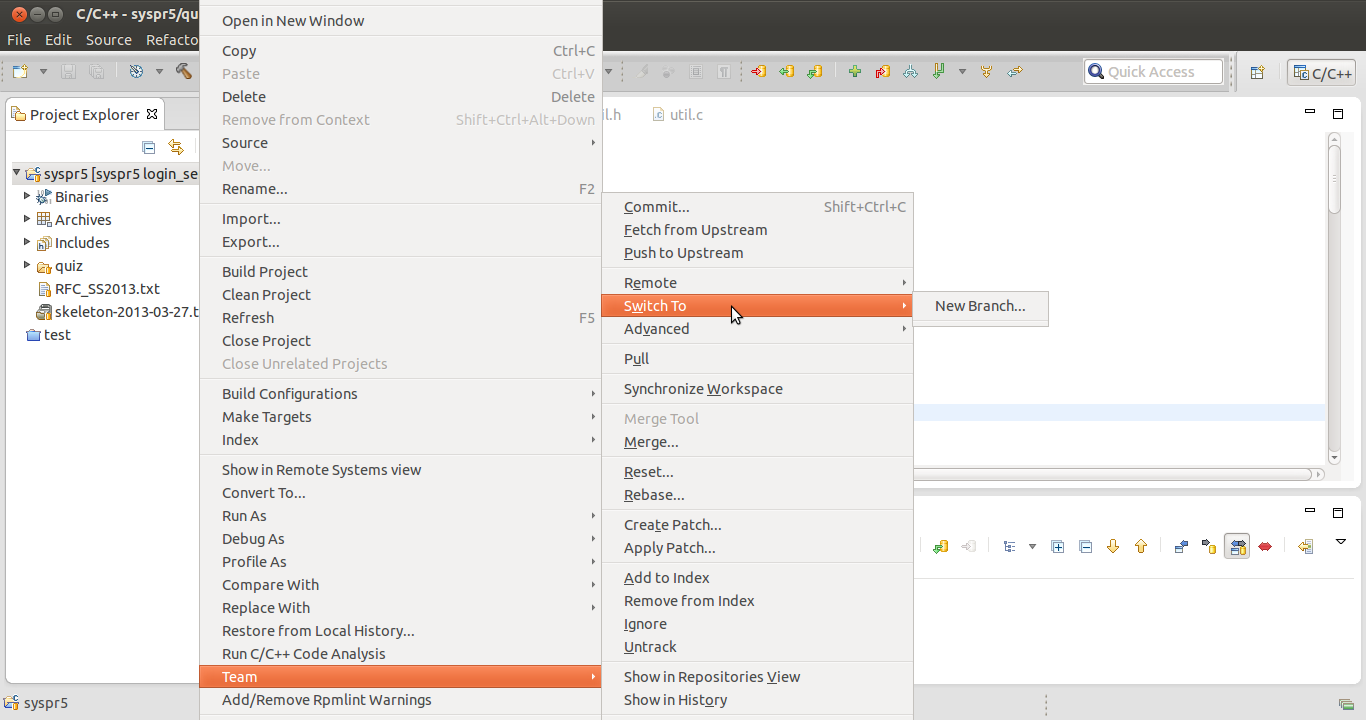

i have a little problem with a C-Project and EGit:
When i right-click on the project -> "Team" -> "Switch To" i only see the option "new Branch". I have no list with my branches or the option "other".
I have Eclipse Juno CDT with EGit 2.3 and use a remote git-server.
  • Attachment: Egit.png
    (Size: 145.81KB, Downloaded 386 times)
