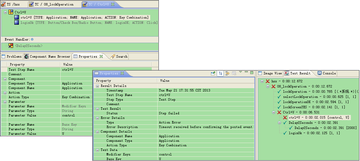

There is one situation which is some like this problem: Execute External Command.When i first execute one external command ,it occured the same mistake. But execute external command offer one more parameter for timeout set. So use this parameter prevent this error. Is there any method to set the time of timeout for Key combination and other actions?
I offered the attachment show the imformance of error while execute Key combination and the properties of the test step. Wish it could be helpful.

There isn't a central / per action way of doing this, no. There is an environment variable that lets you ignore them completely, but I don't know it off the top of my head. I'll investigate.
Alex

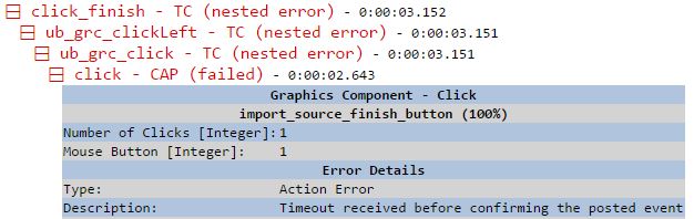

I'm having the same problem. I'm running tests remotely ($ jubula_8.2.0.021/jubula/testexec -testsuite MySuite -dburl jdbc:mysql://db.mydbserver.org:3306/MyTestDB -project MyProject -language en_US -version 1.0 -dbuser MyUser -dbpw MyUserPassword -port 60000 -resultdir /path/to/results -autconfig MyAUTConfig -server my.virtual.machine)
This problem occurs quite randomly but constantly.
In the attached images you can see how the timeout occurred on an active and 100% found object causing the click - CAP to fail.
Since I'm running an executable program, looks like there is no way to pass argument to the jvm (-DGD_IGNORE_TIMEOUT=true).
So, it's there another way to disable or adjust the timeout?
Thank you.
