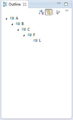

Hi all ,
I can try nested task without any seperator.(for example dont use comma or curly bracket)My grammar is below.Solved ambiguity with => sembol.but I want to breaked output ( such as example output
A
B
C
D
E
My grammar output is in the Attachment. Tasks is nested everytime .How can I solved this problem ? I try some method but can not succesful.

Re: Recursive Grammar [message #1043787 is a reply to message #1043564] Thu, 18 April 2013 01:56 Go to previous messageGo to next message
HI,
(1) first your grammar does not fit to the model.
(2) in your grammar a task can contain subtasks
(3) what shall be the the criterial to start a new todo?
Re: Recursive Grammar [message #1043805 is a reply to message #1043787] Thu, 18 April 2013 02:35 Go to previous messageGo to next message
Hi Christian,
My aim is to generate a language which accepts a program like:
 task t1
            task t2
                 task t3
            task t4
                 task t5
        task t6
Do you have any suggestion for the grammar of this language?
Best Regards
Re: Recursive Grammar [message #1043818 is a reply to message #1043805] Thu, 18 April 2013 02:54 Go to previous message
there a some threads about indention based grammars. you may have a loot there but it will not be an out of the box solution
