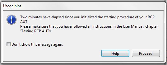

After a short time, an error message pops up (see image; index.php/fa/14394/0/).

Did you actually do all the required steps for testing RCP AUTs? Please check the documentation mentioned in the "Usage hint" dialog. It's especially crucial to add the RCP accessor bundle and configure its start parameters.
- Achim

In with document find "Usage hint" dialog?
What you mean with „crucial to add the RCP accessor bundle and configure its start parameters"?

The documentation for starting RCP AUTs for the 1.3 version is here.
