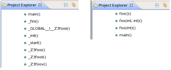

Unfortunately, the differences between these binary parsers are not described in CDT Help. Googling brought me to this old thread. Many tutorials for configuring Eclipse CDT suggest to switch to "GNU ELF parser" without actually explaining the differences with "ELF Parser". Here is what I found:

- When compiling C++ project with debug info, the basic "ELF Parser" gets demangled function names from the debug info. But, when compiling without debug info, it does not demangle function names. That's where 'c++filt' in "GNU ELF Parser" comes into play.
When expanding the binary compiled in "Release" configuration in 'Project Explorer' view, the function names appear mangled when "ELF Parser" is enabled. But, with "GNU ELF Parser" the names appear demangled as in the source code.
