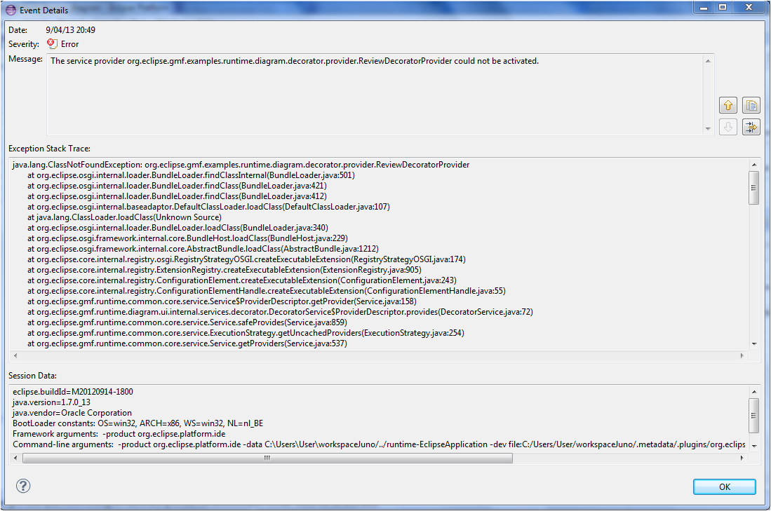

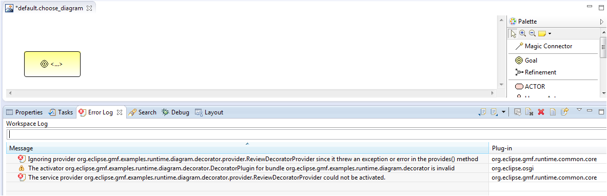

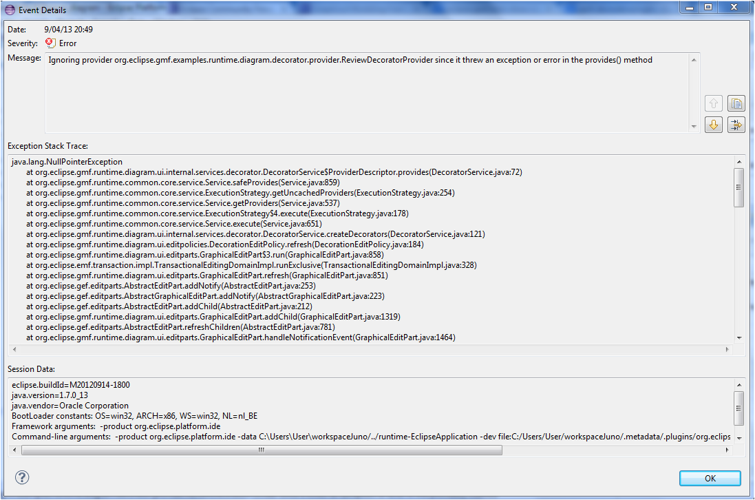

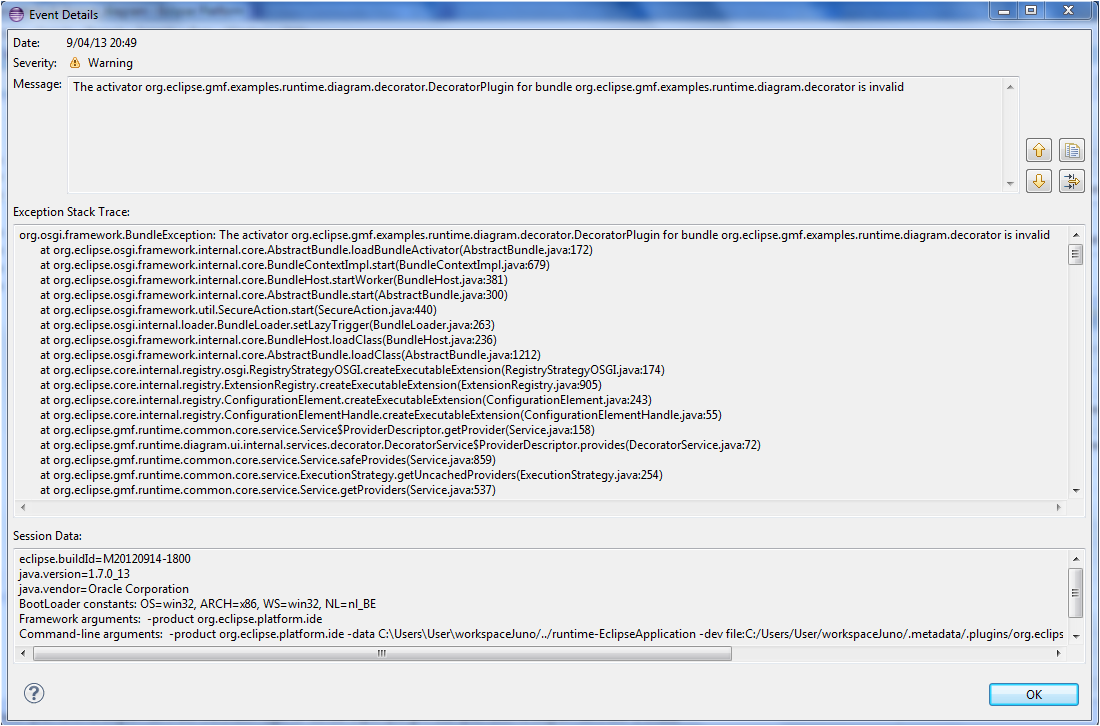

I created a GMF editor, and resolved all but 2 errors (see attachment), that appear as soon as i create a node on my diagram. Probably caused by the activator ...DecoratorPlugin is invalid warning?
I really have no clue where i can solve this problem, I've never debugged a project, and since it's quite big it would take a long while.
Does anyone have a clue how to tackle this or where this error could come from?

The errors appear actually in any diagram editor i make in the runtime, so not only in the one project..

as your log says, you are loading gmf's example-runtime plugin somewhere, that is throwing the error, not your native plugins.
Find out, what plugins reference this (maybe it's just in the runtime-configuration), get rid of it and the error should be gone.

Un-selecting the gmf.examples.runtime plugin in the configuration solved it indeed.
Still don't understand why this happened though.
