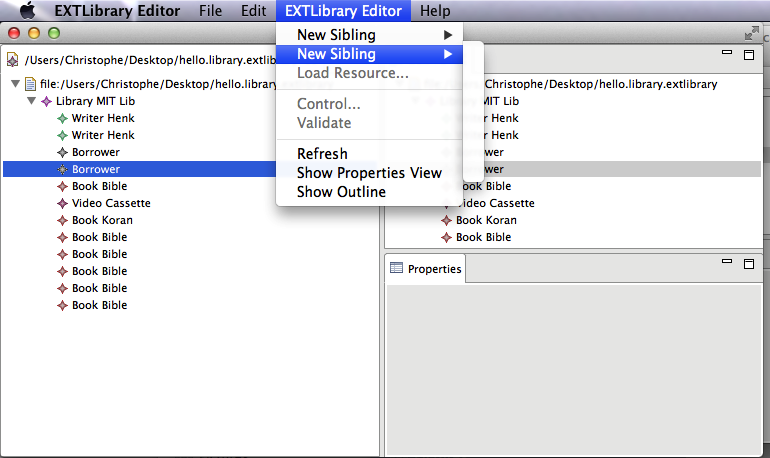

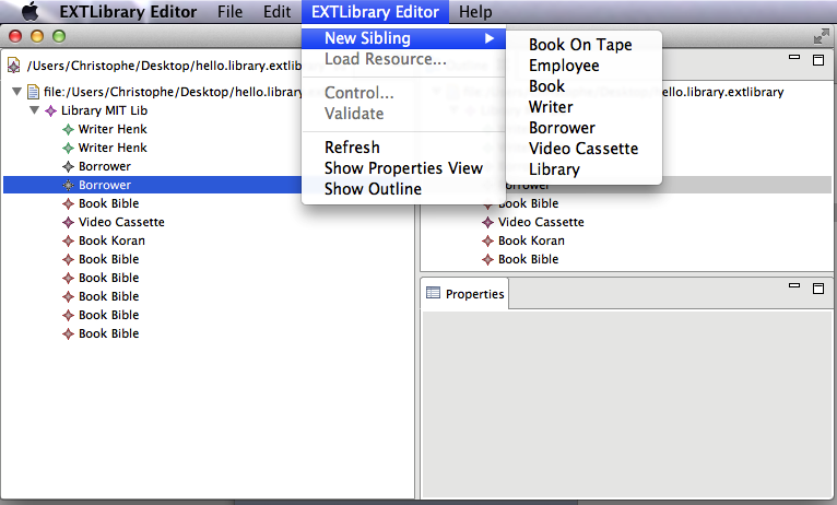

I Simply want to add MMenu's to an MDynamicMenuContribution, which it
does. But the next time I click on the menu I get a duplicate entry for
the MMenu. Hence the 'experiment' to remove them in @aboutToHide. (So
that's a bad, and I won't do it again, promissed ;-)
I have attached two screenshots, notice that the second time the menu is
populated, the first MMenu entry is cleaned, but the MMenu itself is
still there.
So what could cause the orignal menu contribution not to be removed? I
wonder if it's the fact that I am contributing MMenu's and perhaps it's
only tested with MHandledMenuItem and MDirectMenuItem? (Just guessing
here).

The bug your pointed to is slightly different. I do not populate with MMenu items but with MDirectMenuItem items.
These are not growing each time the menu is opened, but are persisting when the application is restarted (and making the menu larger and larger)
I tried to use @AboutToHide to throw the items away manually, but this does not help.
Unfortunately, I am unable to debug the problem properly as I am using Linux and debugging it freezes X...
