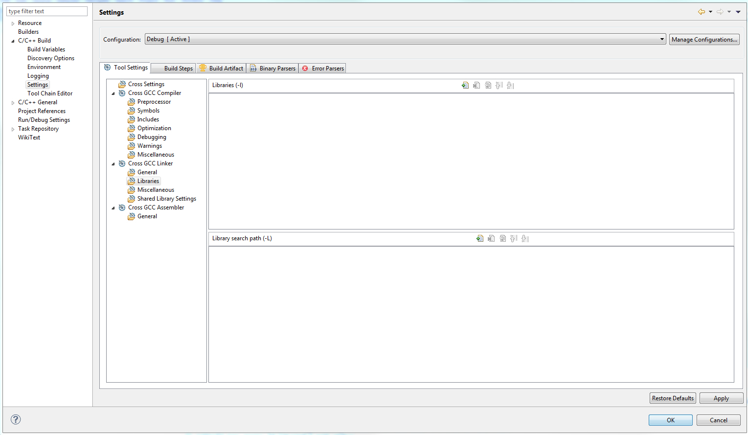

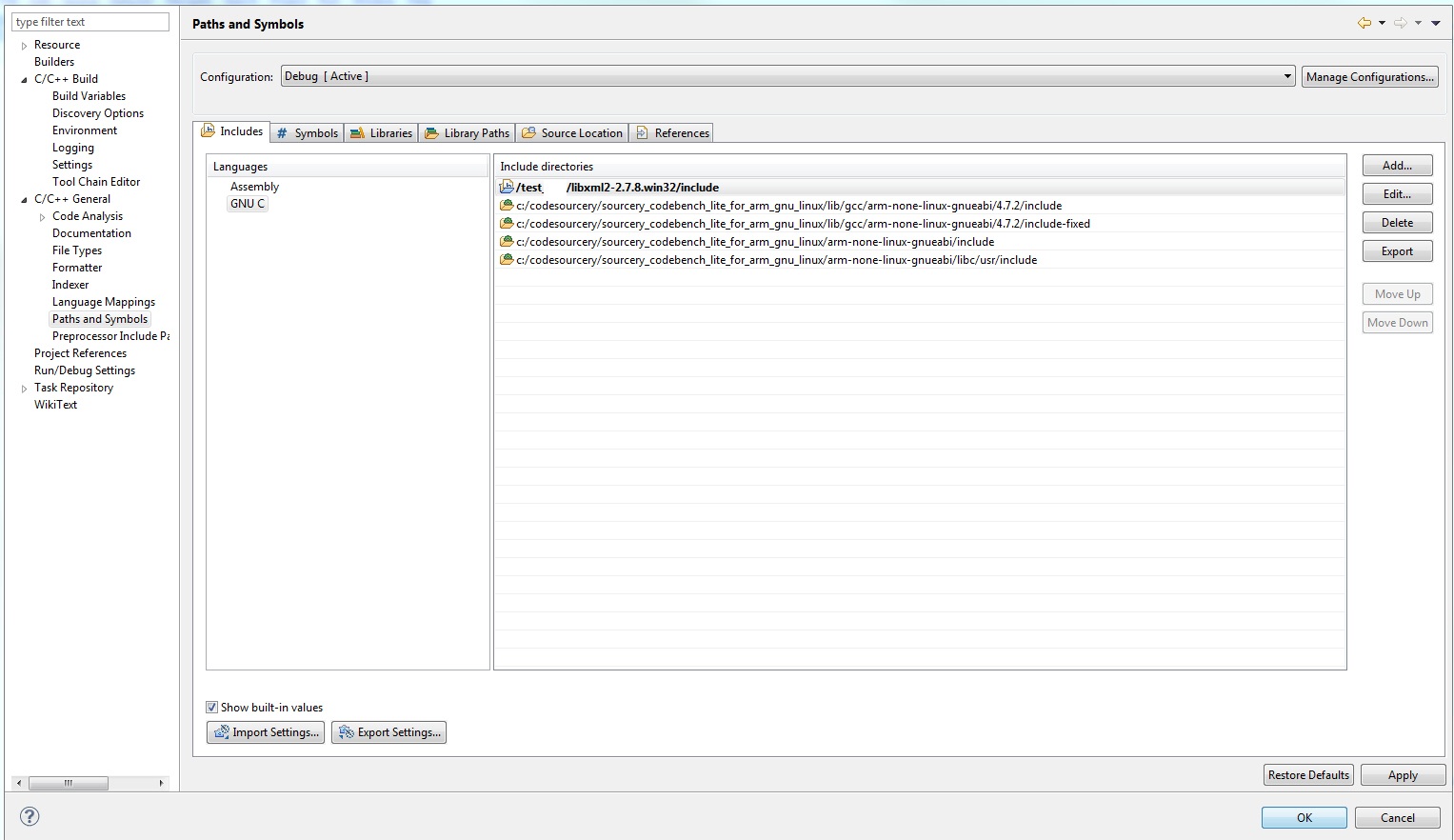

Hello Axel,
I tried this configuration and now I get the error "undefined reference to ...(used functions from library)". As attachement I sent screen shots of my C/C++ Build configuration.
What I do wrong?
