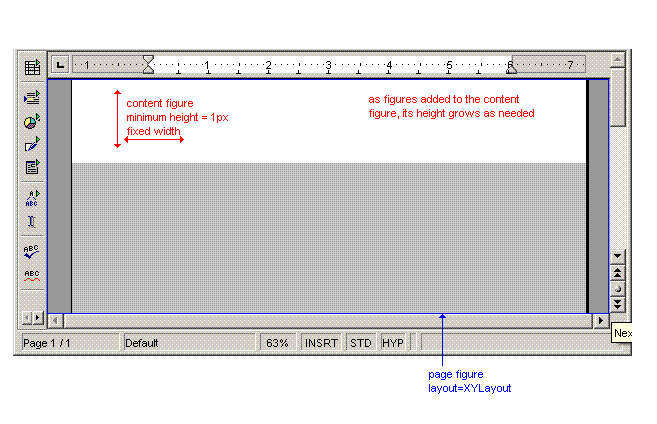

Hi, I'm trying to create a figure that'll have a flow layout. It has fixed
width, but the height is not fixed. The height is calculated based on the
children.
And it looked like the attached picture.
So my approach is like this, I was wondering if this approach is ok, or if
there is a better one.
So first you have a
PageFigure. PageFigure will draw a paper look a like thing using
graphics.fillRectangle, it uses XYLayout. Then PageFigure has a
ContentFigure. Then the ContentFigure uses a FlowLayout and figures can be
added to ContentFigure.
Basically I'm trying to create something that will look like an HTML Editor.
Please give comments on my approach
many thanks,
Michael

> So first you have a
Something different to try:
Let's call what you have as PageFigure a DocumentFigure. The DocumentFigure
can have one or more PageFigures (this is the actual visible page, including
empty space) in ToolbarLayout. Each PageFigure will have two children in a
border layout: a content figure (north) and a shaded figure (center), which
shades the empty space. As the content figure grows, the shaded figure
shrinks.
A better/simpler option would be to not have the shaded area. Then your
PageFigure can have the content figure in a stack layout. Adding stuff to
the content figure would work similar to adding parts to the FlowContainer
in the logic example. When you run out of space, you can add another
PageFigure to the DocumentFigure.

Hmm, I didn't realize you were creating an HTML editor (just went by the
picture). In that case, why do you want your editor to look like Word
rather than FrontPage?
DocumentFigure
including
a
which
> shrinks.
> "Michael Permana" <mpermana@hotmail.com> wrote in message
> news:cho5k9$5hf$1@eclipse.org...
fixed
the
> > children.
if
> > So first you have a
be
> Editor.
> > many thanks,
> > Michael
