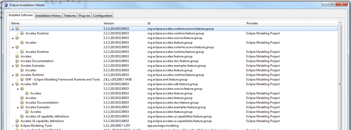

I installed Acceleo with Eclipse Juno (4.2) using the Acceleo 3.3 update site (http://download.eclipse.org/modeling/m2t/acceleo/updates/releases/3.3).
Once Eclipse has rebooted, I do not see any visual components of Acceleo, either in the perspective listings or the views. I've uninstalled and reinstalled twice with the same results. That's strange because the list of installed plug-ins does mention the Acceleo plug-ins. And there are no error messages in the Eclipse .log file.

It seems there is a conflict with the Eclipse Modeling package and the Acceleo 3.3 updates. To re-install Eclipse *Classic* and use the Acceleo 3.3 update site resolved my issue. Thanks to Stéphane Bégaudeau for the hint.
