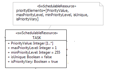

I tried to use org.eclipse.uml2.uml.Element::getValue(Stereotype, String) method to get the value of The attribute "priorityElements" of the stereotype "SwSchedulableResource" application but it doesn't works.
Stereotype appliedStereotype = p.getImportedPackage().getAppliedStereotype("MARTE::MARTE_DesignModel::SRM::SW_Concurrency::SwSchedulableResource");
		if (appliedStereotype != null) {
			TypedElement priorityElements = (TypedElement) p
					.getImportedPackage().getValue(appliedStereotype,"priorityElements");
can you help me please

Hi, Mariem,
To say that it doesn't work is not useful. What happens that you did
not expect, or what does not happen that you expected? Is
'appliedStereotype' null? Is the 'priorityElements' null? Do you get
a ClassCastException? Do you get an IllegalArgumentException? In
either case, provide the stack trace or debug at the point where it is
thrown to determine why.
I would expect a ClassCastException because one of your previous
messages suggested that 'priorityElements' is a multi-valued attribute.
This means that its value is an EList, not a TypedElement.
Cheers,
Christian
