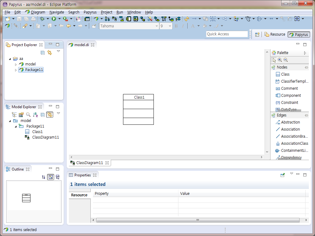

I used Papyrus Nightly Build, N201303200043 (2013/03/20)
The error occurs when
- I controlled a package named Package11.
index.php/fa/13938/0/

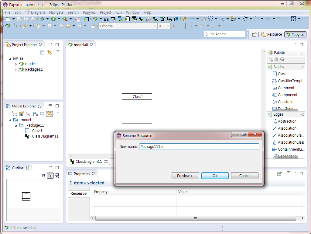

- I rename the contolled model Package11 to Package111.
index.php/fa/13939/0/

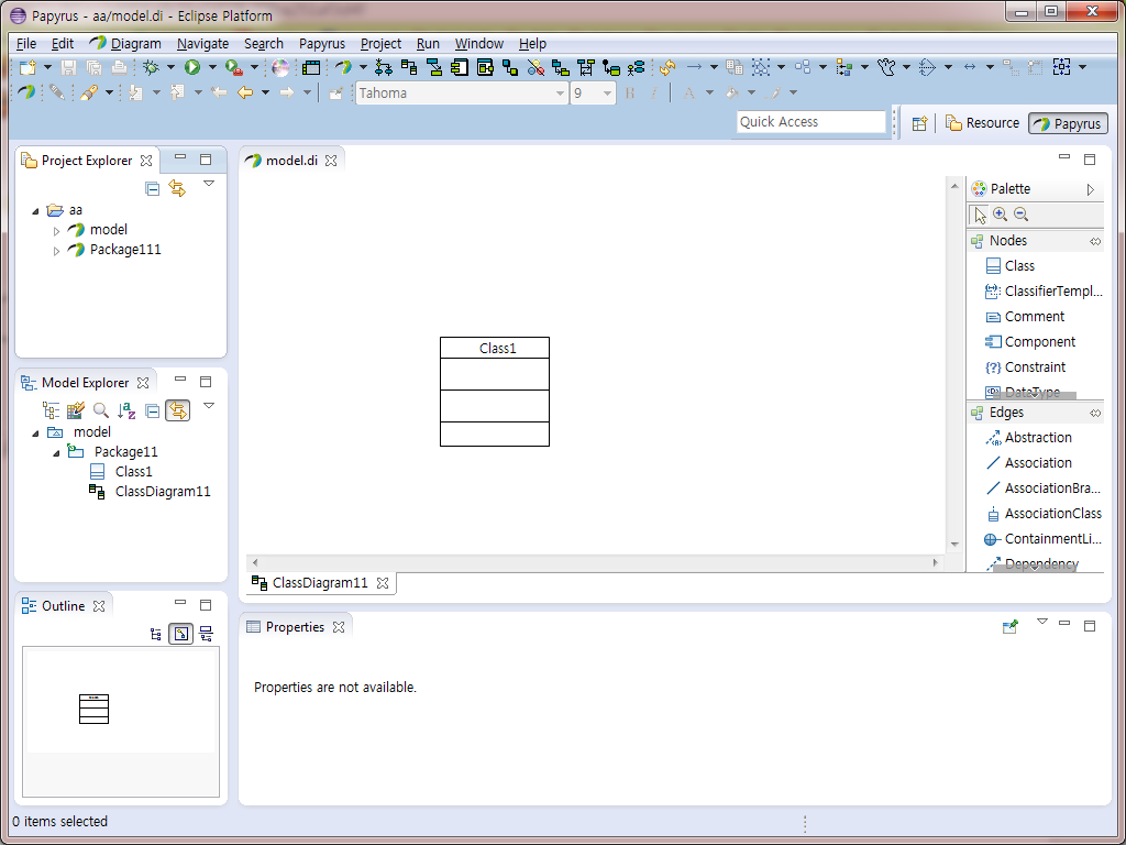

- Rename is successfully done.
index.php/fa/13940/0/

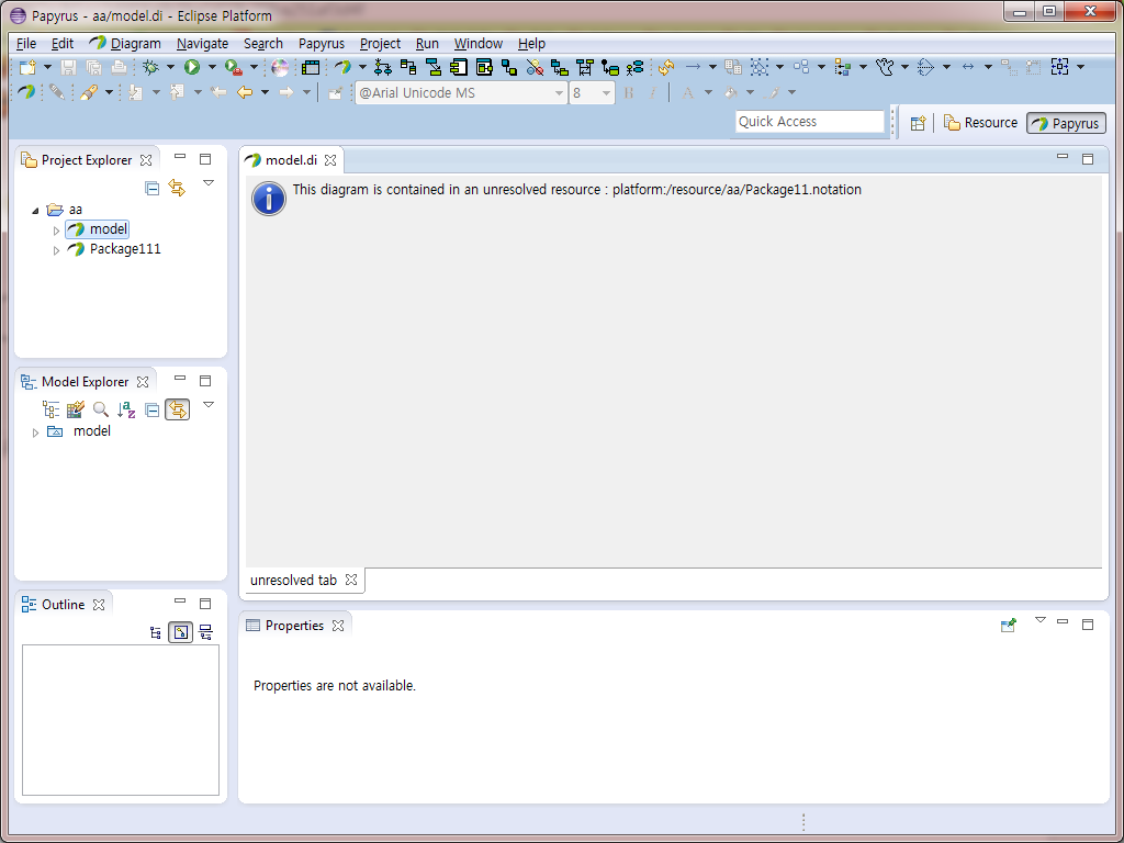

- I close the 'model' which has the controlled package and reopen the 'model' then the error occurs.
index.php/fa/13941/0/

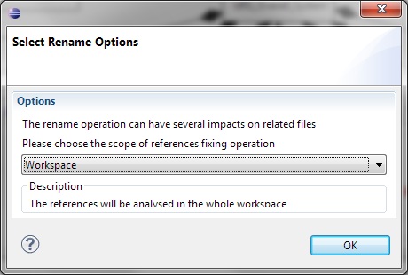

just a quick guess : when you rename a project, there is a dialog (Select Rename Options) which offers an option to analyze the impact of the renaming at Project (default value) or Workspace level.
Did you make sure that the entire Workspace is analyzed ?
index.php/fa/13942/0/
HTH.

Yes, the error still occurs even when I selected 'Workspace', and I think that is natural because both 'model.di' and 'Package11.di' are under the same Project.

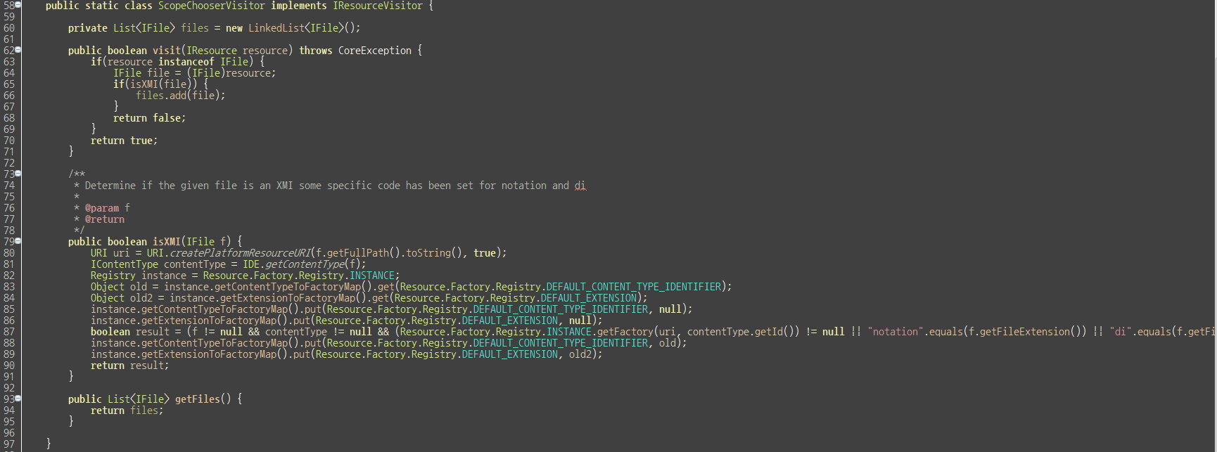

The inner class 'ScopeChooserVisitor' of org.eclipse.papyrus.infra.ui.resources.refactoring.ui.ScopeChooser needs to be modified to fix this error.
index.php/fa/13956/0/
The 'isXMI(IFile)' returns false on the '.notation' file and '.di' file,
because 'contentType' of line 81 is null on those file types.
I try to fix it if possible. Cool
Re: Rename Controlled Model File Error [message #1021989 is a reply to message #1021965] Wed, 20 March 2013 23:51 Go to previous message
I solved this problem. Laughing
Just contributing contentType for '.di' and '.notation' to the Papyrus using 'org.eclipse.core.contenttype.contentTypes' extension point fixes this error.
