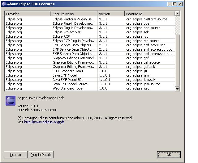

Re: M9 - no perspective [message #148935 is a reply to message #148892] Thu, 24 November 2005 10:45 Go to previous messageGo to next message
I'm attaching the feature's list I have in the about screen...
Does this help?

Re: M9 - no perspective [message #149011 is a reply to message #148935] Thu, 24 November 2005 11:42 Go to previous messageGo to next message
The feature set it not that normal, the plugin list is...
Have you looked for the button Configuration Details -> View Error Log

Re: M9 - no perspective [message #149019 is a reply to message #148935] Thu, 24 November 2005 12:49 Go to previous messageGo to next message
Check your Error Log view (open via Window-Show View). M9 may have had
some problem initializing one of it's plugins - it would be logged
there. This might happen if the workspace that you were using was
previously used by an earlier release. If so, try specifying a new
workspace when starting M9. If that works, delete the contents of the
old <workspace>\.metadata folder (though doing so will of course 'clean'
your prefences, histories etc)...

>> Does this help?
>> "Darryl L. Miles" <darryl@netbauds.net> wrote in message
>> news:4385B724.1000903@netbauds.net...
>>>Zohar wrote:
>>>>Hello,
>>>>I opened a "fresh" eclipse 3.1.1 and in it added:
>>>>emf-sdo-SDK-2.1.1
>>>>GEF-SDK-3.1.1
>>>>JEM-SDK-1.1.0.1
>>>>and
>>>>wtp-1.0M9
>>>>When I started eclipse there was no J2EE perspective, and when trying to
>>>>create a new project, none of the WTP related projects were available
>>>>(e.g.,
>>>>dynamic web project).
>>>>What did I do wrong?
>>>Are you sure you downloaded "wtp-1.0M9"; or was it "wst-1.0M9" by
>>>accident ?
>>>Window -> Open Perspective ... -> Other -> J2EE ????
>>>Darryl
Re: M9 - no perspective [message #149268 is a reply to message #149011] Sun, 27 November 2005 01:56 Go to previous messageGo to next message
news:4385ED6B.3050103@netbauds.net...
>> Does this help?
>>>Zohar wrote:
>>>>Hello,

Re: M9 - no perspective [message #149495 is a reply to message #149438] Mon, 28 November 2005 03:02 Go to previous message
I tried using emf-sdo-SDK-2.1.1.zip instead of emf-sdo-xsd-SDK-2.1.1.zip.
Now that I downloaded the correct one I have the J2EE back - thank you.
