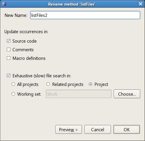

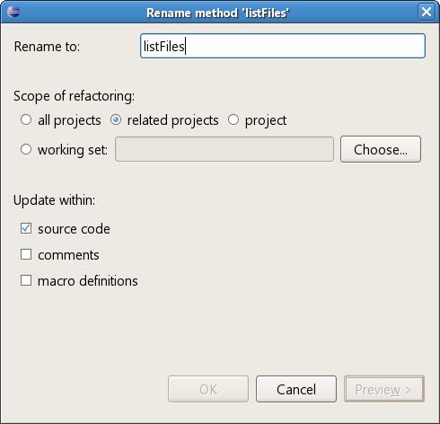

The major difference in refactoring between Galileo and Juno is that the former has "Scope of refactoring" feature allowing to select "related projects", thus the search can only be performed in read-write projects. In Juno, this feature is missing and instead there's "Exhaustive (slow) file search in" option (see the images below).
Can a scope of refactoring be specified in Eclipse Juno for C++ code?
Thank you
Giga
