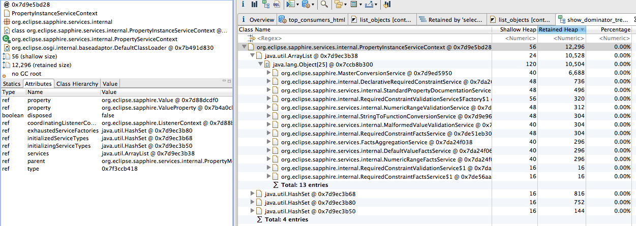

MasterConversionService has definitely been driven off the radar... Thanks for your expedient patch! Memory usage is down to 685MB (total for eclipse) from 700MB for the 1.5MB XML file. Looking at the memory analyzer again, there looks like there might be some more low hanging fruit... (I guess the term low hanging is relative judging from the 100 files updated for 85a2748... )
Currently on the top of the "Biggest Top-Level Dominator Classes" list is org.eclipse.sapphire.services.internal.PropertyInstanceServiceContext. Digging into the dominator tree for this object, org.eclipse.sapphire.modeling.el.Literal$1 floated to the top.
In the current model/file that I am using, there ends up being 326,153 instances of these Literal objects. A couple of interesting stats that I noticed about these literals:
1. There are 68217 literals with the value of null, each taking up 376 bytes = ~25MB of "nulls". I haven't had the chance to trace the origin or study if any of these "nulls" are used for the Function.origin members instead, but at a first glance, it would seem that these have the potential to be replaced with the same static copy of Literal.NULL
2. For a literal text value of "false" 520 bytes are retained by the literal object. (376 of these being the literal's overhead). 144 bytes of storage for a 5 character string seems bit off (a bit of googling and some math seems to indicate that this should be 56 bytes for a fresh string.). Also, I noticed that the Literal class had true/false static values which might be of service here (although this will probably take some tweaking on the model to get the data types to be translated through the model correctly).
2. There are 2686 copies of the following literals (each 1032 bytes) for a total of ~2.5MB. Appears at first glance to be ab bit redundant...
