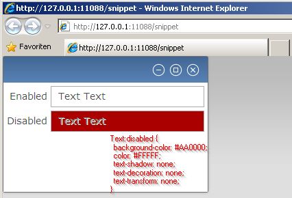

RWT renders Text widgets as HTML input elements with style.
Disabled Text widgets are rendered as input elements with disabled=true.
While theming works fine on these elements in mozilla and webkit browsers, IE ignores it.

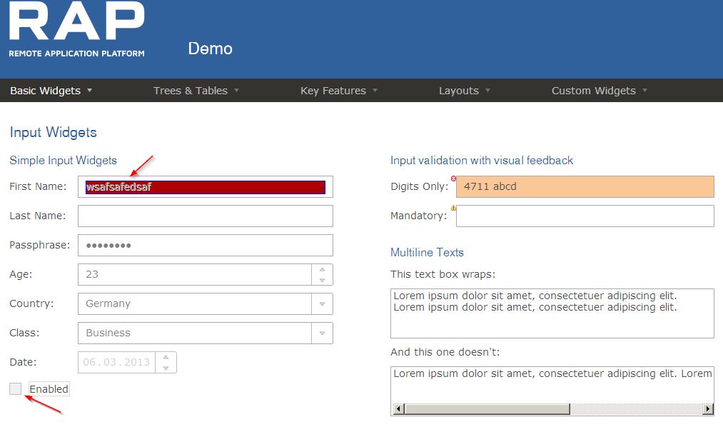

You might reproduce it starting up the RAP demo and changing the rendered HTML with some web dev tool.
I do not have an idea how to fix or workaround. You?

If I remember correctly, this is not an issue of RAP. It is an IE isse thst
dors not allow the change of the background color. Maybe IE10 csn do it,
but IE 7-9 does not. A common workaround is to use readonly instead of
disabled.

Maybe it is possible to let the client part of RAP handle this quirk of IE.
Rendering the disabled Text as <div/> instead of <input/>?
