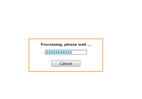

I'm trying to use the sample WebViewerExample to run BIRT reports on a server. I've deployed the new webapp to tomcat and I can reach the front page which lists the version number. When I go to run a report, it stays at the "Processing, please wait...." screen without ever loading/running the report. This same report runs in the BIRT Report Designer.

Note - I attached a screenshot of the "Processing, please wait...." dialog box that BIRT hangs on.

You should be able to configure the log location and logging level in the web.xml. As for the test report not working, what is your Java version you're using for Tomcat? You might also try re-downloading the runtime to see if you just got a bad download.

My java version is 1.6.0_27. Is that not a supported version?
I don't think my download was bad because I installed my downloaded copy onto two servers - it worked on one but not the other. I don't see the difference between the two setups either. I wish that I had an error message instead of BIRT just looping when I try to run a report.
Re: Logging for WebViewerExample [message #1015499 is a reply to message #1015494] Thu, 28 February 2013 15:22 Go to previous message
Same java on both? What is the BIRT version? Can you try downloading again, too, just in case.
