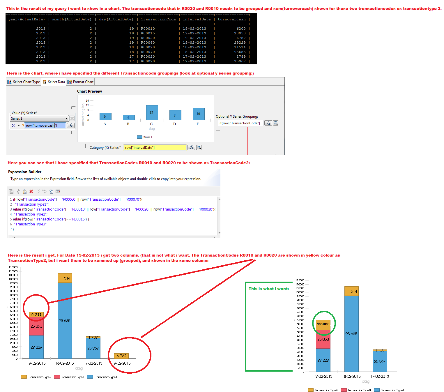

i have created a chart in birt.
And i am trying to group and sum column values in birt chart, without succeeding.
I have created a image which explains what i want to achieve. Could you please look at the attached image, and see how i can fix my problem ?
index.php/fa/13576/0/
Thank you very much
Re: Chart: how to group column in birt chart ? [message #1015283 is a reply to message #1015039] Wed, 27 February 2013 22:29 Go to previous message
Next to the x-axis field text box, in the chart editor, there should be a button for grouping/sorting for the axis. In the attached report, I create a dataSet with your data, in script and create the same chart you're looking for. Let me know if you have questions.
