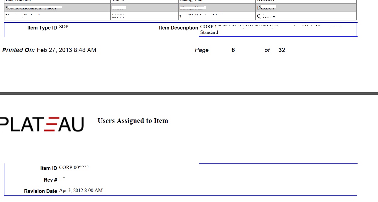

this is what I want to do, but even when I do all of that it does not work. I have the code and the pagebreak from the library, but when I reset the pagebreak to "Auto" so it will rely on the script, it does not page break at all. See attachment.
  • Attachment: Sample.jpg
    (Size: 90.77KB, Downloaded 1008 times)
