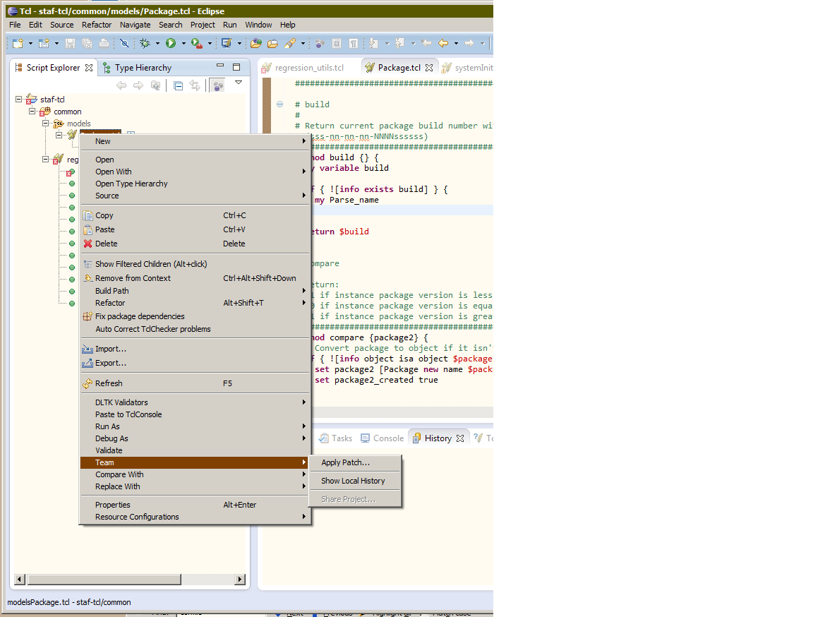

I'm using Egit with DLTK (Dynamic Language Toolkit) to work on Tcl source code. When I right click on a source file name in the Script Explorer and select Team, the menu is very impoverished compared to what I see in the EGit website documentation.
index.php/fa/13494/0/
The same problem happens if I have a Java project open.
The file icon decorations that EGit is supposed to supply are also missing.
Any idea what might be wrong?
-- Doug

Sounds like you didn't import the projects correctly. The most reliable approach, particularly for versions of EGit older than 2.3, is to add your local repository to the "Git Repositories" view, then use the right-click popup menu on that newly added entry and select "Import Projects..."
Re: Team menu impoverished [message #1012523 is a reply to message #1012438] Thu, 21 February 2013 13:06 Go to previous messageGo to next message
That fixes it, thanks.
So projects in Git should be imported via the Import in Git Repositories rather than the one in Project Explorer. Looks like you might also be able to do it via the Project Explorer Import by selecting Git|Projects from Git.
