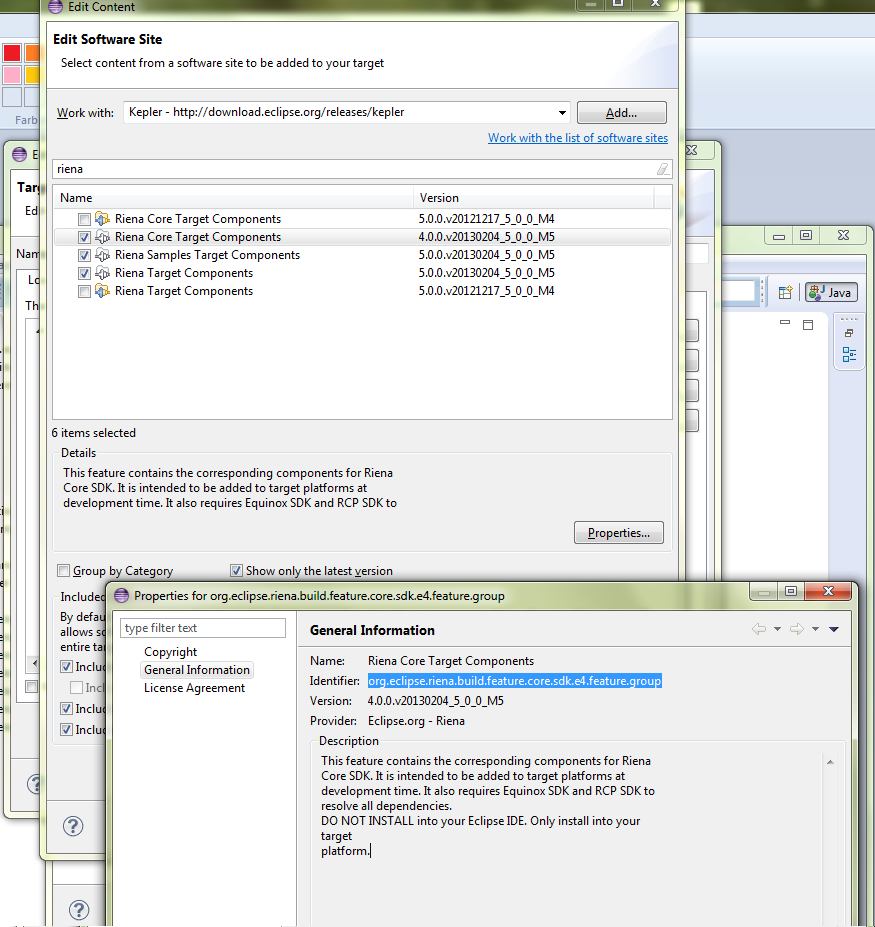

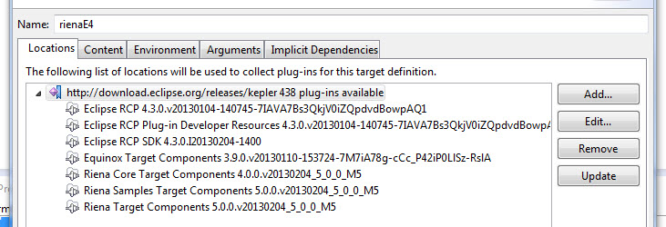

1. I have now installed Eclipse 4.3.
2. Created a target platform (see also attached screenshot..)
-Equinox Target Components
-Eclipse RCP
-Eclipse RCP SDK
-Eclipse RCP Plug-in Developer Resources
-Riena Core Target Components
-Riena Samples Target Components
-Riena Target Components
3. Importet the Riena Client Example
4. Added SWT to the build path
5. Added automatically the required plugins within the run configuration.
Now I get the following error by starting the example: java.lang.NullpointerException
I have no idea, if there are missing additional components are I have used a wrong combination of versions..
Thanks in advance!

Hi Max,
I noticed one thing while setting the Riena target platform. These components appear twice in the list (your step 2):
* Riena Core Target Components
* Riena Target Components
Though they have the same names, they are different. Make sure, you select only the ones that include "e4" in their identifier (e.g. org.eclipse.riena.build.feature.core.sdk.e4.feature.group). You can check the identifier usind the "Properties..." button below the list and going to "General Information". See the screen shot.

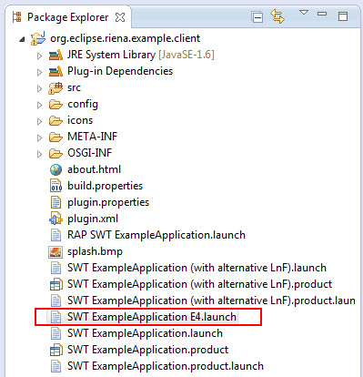

You are launching the launch configuration "SWT ExampleApplication". Note that there is also a launch configuration "SWT ExampleApplication E4".
In the launch configuration dialog, check "Include optional dependencies when computing required plug-ins". It should work then.
Please reply, if you have more errors or questions.
Cheers,
Jordan

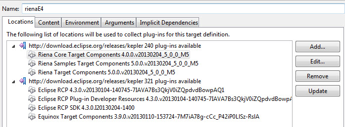

Re: Eclipse package for Riena [message #1014487 is a reply to message #1014357] Mon, 25 February 2013 17:46 Go to previous messageGo to next message
Hello Jordan,
many thanks for the hints!
I started with completely new eclipse installation.
1. Unpack eclipse-SDK-4.3M5a-win32.zip
2. Create a target platform rienaE4 with the right E4 plugins (Screen shot)
3. Create a source project from plugin org.eclipse.riena.example.client
4. Add required plugins for launch configuration SWT ExampleApplication E4.launch
--> The example project itself is now error free.
==> But there are still some problems by starting the example project. Sad
Thx!
Max

the Eclipse Riena example still doesn't works for me.
I have created a screencast of my installing procedure.
materialordner.de/UKy6Y7oPKfj0tUDZc6O1ywFCODvYJ0St.html
What I am doing wrong?
Thanks in advance!
Kind regards,
Max Reeb
Re: Eclipse package for Riena [message #1015339 is a reply to message #1015327] Thu, 28 February 2013 04:35 Go to previous message
Hi Max,
in the step where you "add required plug-ins" to the launch configuration, also check the "include optional dependencies" checkbox below the bundles list.
5:28 in your screencast.
