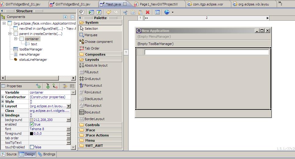

I can not find GroupLayout in the Layouts (SWT) in the palette. I have indigo 3.7 with the corresponding Windows Builder complete installation.
Any suggestions?

When WindowBuilder became an Eclipse.org project in 2010, the SWT version of GroupLayout was removed due to IP issues. The supporting code was moved to an Eclipse Labs project...
http://svn.codespot.com/a/eclipselabs.org/windowbuilder-extras/trunk/
Note that there are two WB builds out there... the one at Eclipse.org that does not include SWT GroupLayout and a second build maintained by Google that does...
https://developers.google.com/java-dev-tools/download-wbpro-beta
Personally, I think GroupLayout is pretty nasty so I don't recommend it in any case (pretty much write-only and very fragile). SWT GridLayout is far superior for SWT/RCP work and can do pretty much anything you could ever want.
