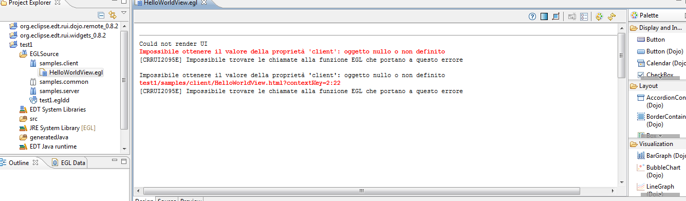

i saw that the new release of EDT (082) so I tried to install it to see if my OLD problem go away. Once installed the new release I created my test project and when I try to open the HellWorld View.egl I receive this errors message :
Could not render UI
impossible to get the properties's value 'client': void object or not defined
[CRRUI2095E] impossible to find the calls to the function EGL that brings to this error
test1/samples/client/HelloWorldView.html?contextKey=2:22

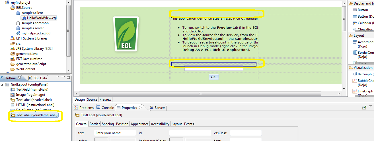

when i create a new workspace and then i create a new project from the template "Hello World" the first time i open the preview i receive the errors that i listed (see also img attached) Then this error don't come showed more, but i have always the old problem that i don't see (either in the design and preview) the "textlabel" (see img2 attacched)

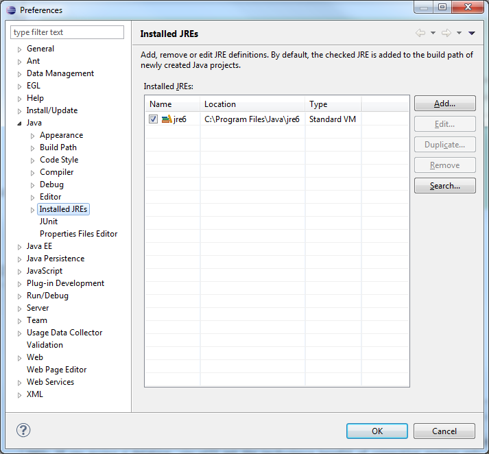

Also, what JRE do you have selected within Eclipse...
Window > Preferences > Java > Installed JREs
See the attached for my settings.

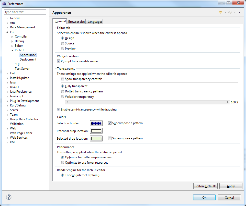

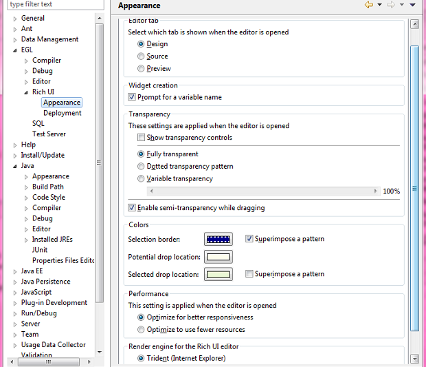

What render engine are you using?
Window > Preferences > EGL > Rich UI > Appearance

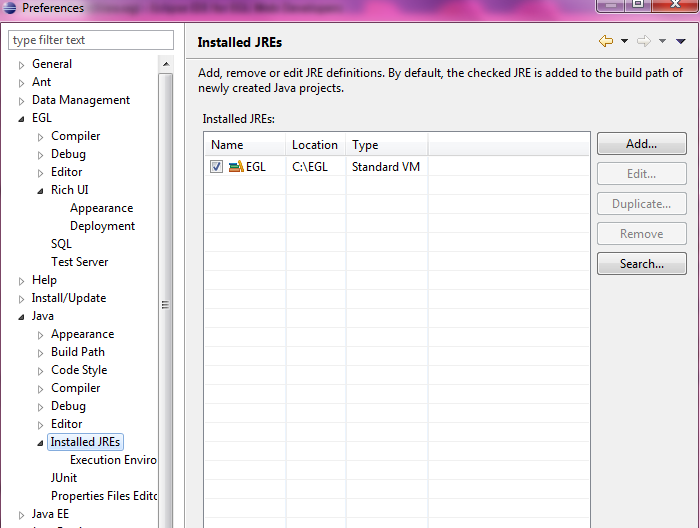

See the attached
see the attached

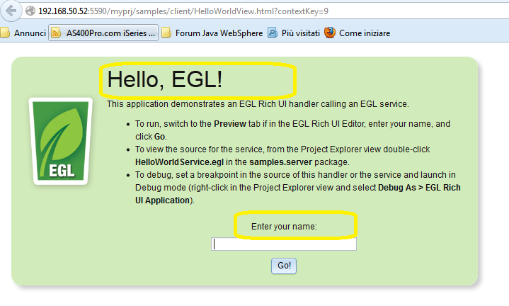

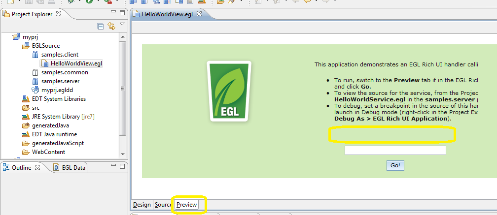

i have reinstalled JAVA And JDK from i have reinstalled EDT ; now the error CRRUI2095E has gone away but i still the problem that in design and preview mode i don't see "TextLabel" field instead if i run the application in a external browser i can see them;
see attached files

Now this i my java version :
java version "1.7.0_13"
Java(TM) SE Runtime Environment (build 1.7.0_13-b20)
Java HotSpot(TM) 64-Bit Server VM (build 23.7-b01, mixed mode)
and attached the installed JRE

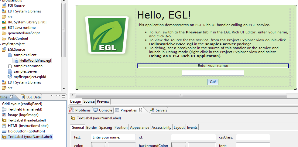

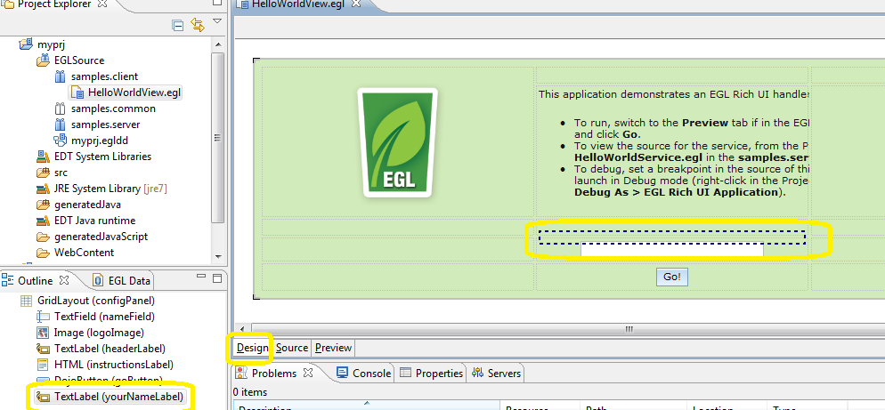

The image of the HelloWorldView.egl in design mode looks different to mine (see attached). I am assuming you've not changed the code. Other than the fact that the textfield isn't displayed correctly the columns are different sizes, etc.
So, my gut feeling is that this is either something to do with the render engine or possibly your version of java.

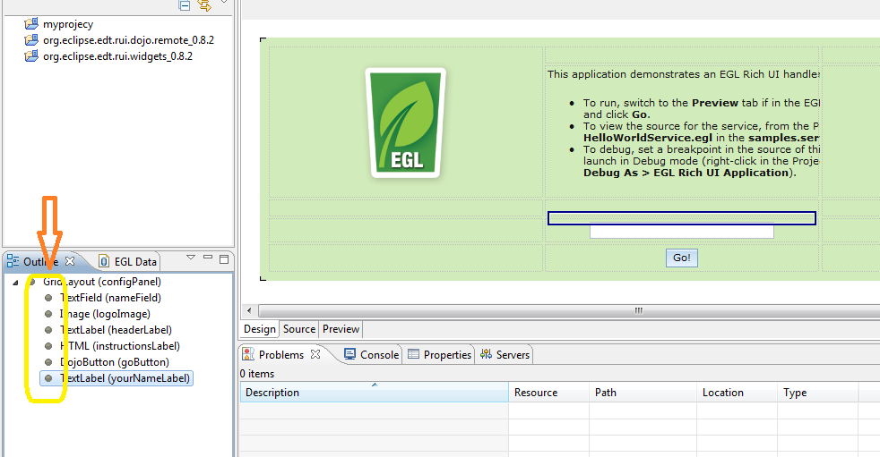

unfortunately the problem is not resolved even installing JRE6, i have also
noticed that the first time that I open HelloWorldView the icons in the part "Outline" they are not correct (you see attached ). I was asking me me: is not there possibility to activate log or other to have trace of possible errors? in my pc I have also installed IBM Rational RBD, can be this that goes to conflict??
