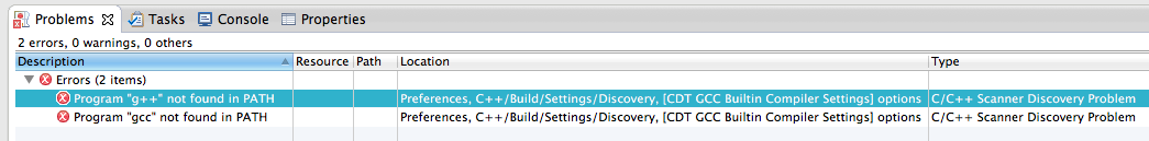

I downloaded Eclipse IDE for C/C++ Developers for Mac and am trying to run a C program. I am getting these two errors when I create a new C project.
Program "g++" not found in PATH
Program "gcc" not found in PATH
I'm assuming this has something to do with the compiler? I am not sure how to set this up, so any help would be appreciated. Is there something I need to mess with in the preferences or something I need to install?
see picture
