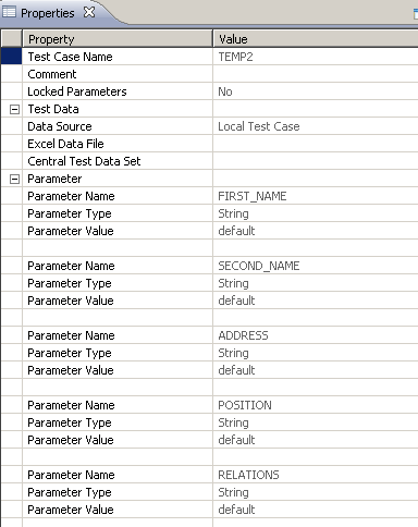

Here is defined test case with default values specified:

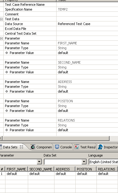

I add it to test suite:
index.php/fa/12973/0/
Here are default values being set as expected:
index.php/fa/12974/0/

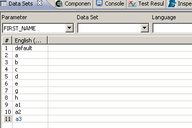

I need to call this case severeal times for various values of parameter FIRST_NAME.
So I define values for the parameter:
index.php/fa/12975/0/

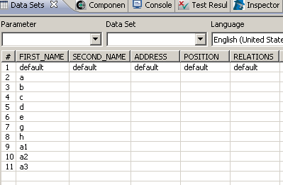

Now I expect to have data set with values I entered for FIRST_VALUE and all other values propagated from default settings. However other values are empty:
index.php/fa/12976/0/
So, I need to manually enter missing values that is quite uncomfortable.
Eg: to repeat case with 10 parameters 10 times for only one of paraemters I will need to fill 81 more absolutelly unnesseccary for current scenario fields.
Alex.
