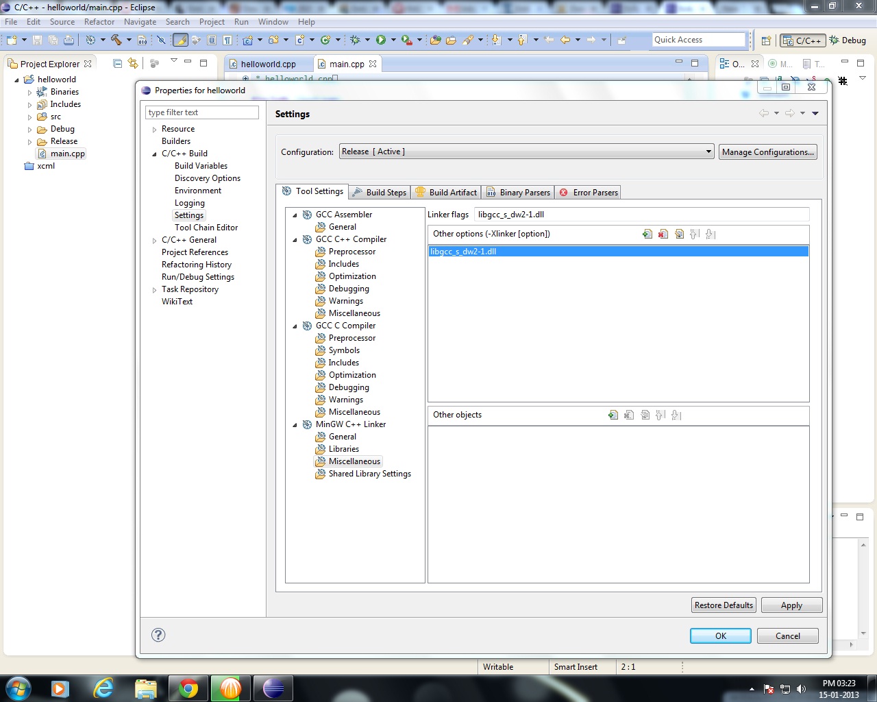

I tried the first option but it did not work. I copied the dll to the Release folder of the project.
I copied libgcc_s_dw2-1.dll to Projects Release folder and then ran the .exe from DOS prompt. It asked for another file libstdc++-6.dll. I put that also in the Release folder and ran the .exe from the dos prompt and I got the output but it doesn't work in the eclipse C/C++ IDE's console.
