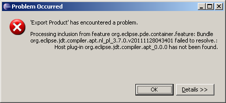

Hi, I'm developing my own eclipse plug-in. I configured target platform, and created product configuration (*.product). Everything is working fine. A few times a week I exported new product. Now my colleague will work too on this plugin. I gave him target platform, and he can run application. But when he try export product eclipse shows error:
Processing inclusion from feature org.eclipse.pde.container.feature: Bundle org.eclipse.jdt.compiler.apt.nl_pl_3.7.0.v20111128043401 failed to resolve.:
	Host plug-in org.eclipse.jdt.compiler.apt_0.0.0 has not been found.
How fix it?
Re: Export Eclipse RCP Product problem [message #998557 is a reply to message #998134] Thu, 10 January 2013 03:34 Go to previous messageGo to next message
  • Delete the .metadata directory from your workspace and restart
  • Ensure that your workspace and projects have all the necessary permissions, try 777 for now.
Re: Export Eclipse RCP Product problem [message #1014223 is a reply to message #998557] Mon, 25 February 2013 06:53 Go to previous message
I recently had this problem. It was solved by providing additional meta-data to all platform-specific features in my project. Follow these steps:
1) Open the feature.xml amd select the Overview tab.
2) Add supported environments information.
3) Open the Plug-ins tab.
4) For all fragments add Operating Systems, architecture, etc.
