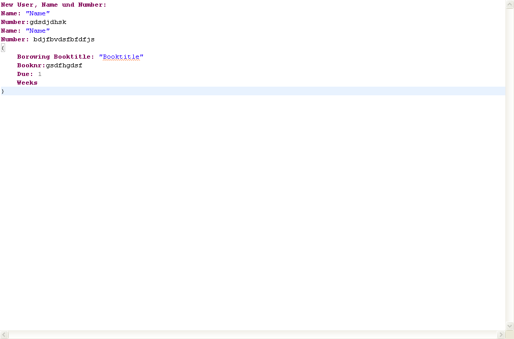

I tried the same with Eclipse Juno and is working fine..
Please see the attachment for the grammar and screenshot of the editor.
I have some things to recommend to you
Firstly, (Borower+=Borower+)
make it (borower+=Borrower+)
use small case, AS in Modeling framework small case is used to represn attributes, refrences, associations. So also readability increases.
Secondly, Design you Grammar , keeping in mind of user.
The DSL is not easily understandable.
