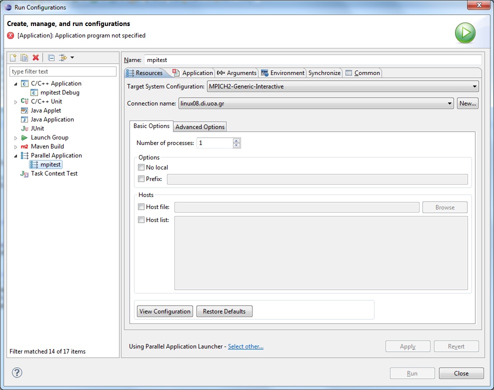

In addition, how do i setup the "Run Configuration" in eclipse? Where do i place the commands needed to run on the cluster? Which program is going to show me the graphical representation of the results? (i thought was GEMS) I have made the connection with a cluster machine but cant go any further! I need some guidance and i cant find anyone who really knows how to set those tools up!

I would also like to get some help on setting the Run Configuration for cluster (from windows targetin a linux cluster).
