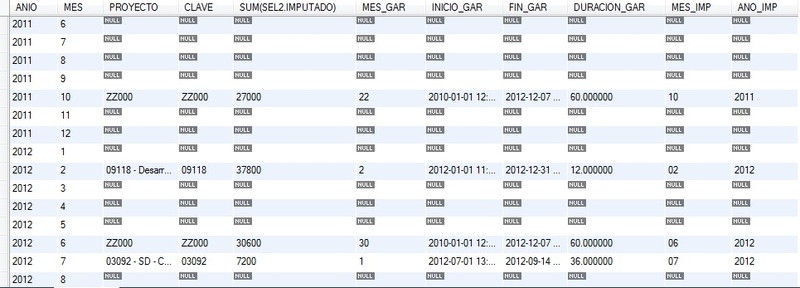

Hello Guys, im new in the forum, i arrived here searching in the web my problems.
I'm working with a mysql database.
i have this query that include projects in guarantee, with their start date and duration, i need to order it by year and month, and when i have nulls, i need to show them too like the first attached image.

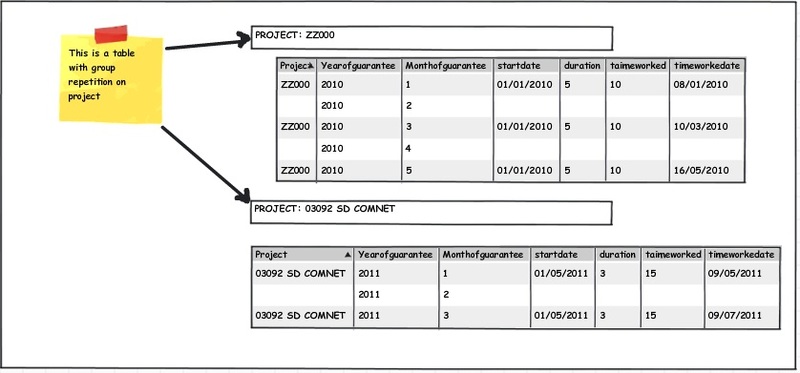

I need one table for each project. I use a table with the same dataset, whith only the project column and a group by project. Inside i had put the same data set with all columns. But it's no working.
Sorry for my poor explanation.
I attach one image more
index.php/fa/12820/0/

this sql query shows this,(i attached it in the topic)
Thanks for your help!!
if you need anything else just ask for it

I understand what you're trying to do with the grouped table and the detail values underneath, but what are you wanting to do with all the NULL values? I'm not sure I'm understanding that part. Also, what is your BIRT version?
Re: Needing some help to show data [message #996486 is a reply to message #994905] Wed, 02 January 2013 02:36 Go to previous messageGo to next message
Thanks for your response Michael.
What i try to show is information about projects by month, whether there's data for them or not. For null data i should display that month with empty rows, or whatever... The important thing is just displaying them.
The version of Birt is 4.2.1
[Updated on: Wed, 02 January 2013 03:38] by Moderator
Re: Needing some help to show data [message #997118 is a reply to message #996486] Thu, 03 January 2013 14:12 Go to previous message
Ok. You'll just need to create a dataSet that has values for all of the months and then join that with your data to create the rows that don't exist. Let me know if this explanation is good enough to get you started or if you need a sample that shows forcing each group to have all months, empty cells or not.
