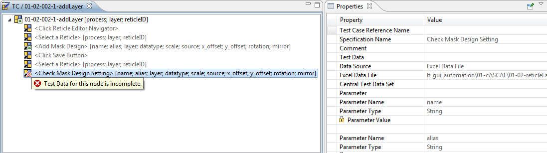

I have a test case named "Check Mask Design Setting". It has variables name, alias, layer, datatype, scale, source, x_offset, y_offset, rotation and mirror. For the case, i didn't provide any data input.
Then i created another test case named "01-02-001-1-addLayer", in which the test case "Check Mask Design Setting" is reused. And I uploaded an external excel file as data input to the case "Check Mask Design Setting". But jubula still had a cross on the case, indicating that test data for this node is incomplete.
index.php/fa/12774/0/
Seems jubula didn't recognize my input data. Because i didn't see an excel marker on the right bottom of test case. Does anybody have similar issue and have workaround or solution for it? Thanks.
  • Attachment: error.png
    (Size: 29.54KB, Downloaded 598 times)
Re: still report "Test Data for this node is incomplete" even an external excel file is pr [message #994412 is a reply to message #993361] Thu, 27 December 2012 03:21 Go to previous message
It was finally found to be a bug https://bugs.eclipse.org/bugs/show_bug.cgi?id=386368
I tried workaround provided and it worked. Thanks.
Workaround: inpout an excel for the original test case and override it in reused test case
